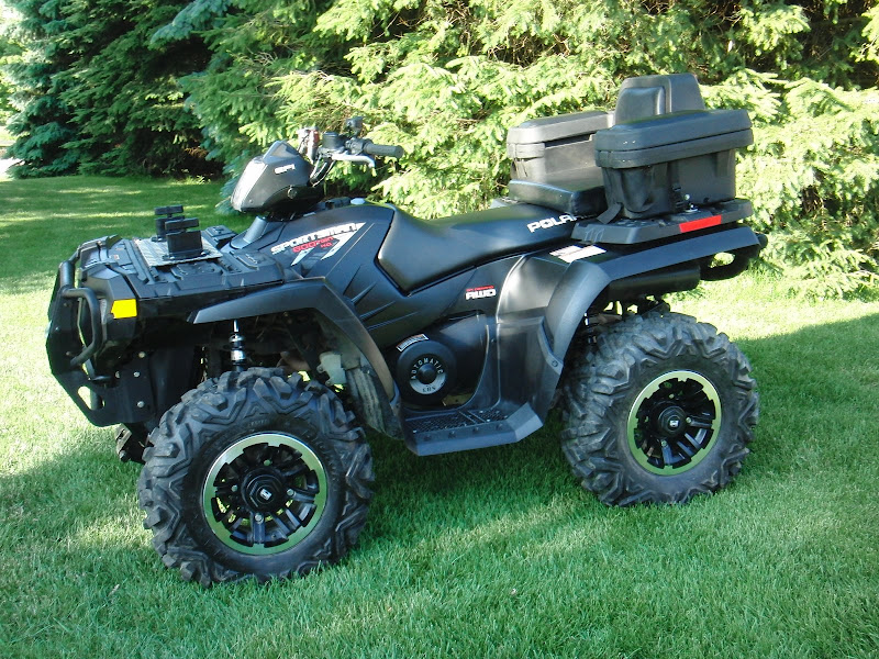

I have a Polaris 500 X2, 25X8X12 front & 25X11X12 on the rear, so if anyone know's the upper limit in front tire width for my machine, that would be a great help.
I've been reading the other snow tire threads and I'm leaning towards the Zilla 26" tall tire, but the width is the biggest question. I like that the Zilla's are lighter in weight and there has been quite a few comments from those that like them and being 6 ply will help their longevity when aired down may-be.
If someone does have wider (10") tires on the front, are they on the stock rims?

Width wise using stock rims - 9" wide tires will probably rub on the TRE. I put 26x9 zilla on my 800 touring, and had to flip the TRE so the tires wouldn't rub.
