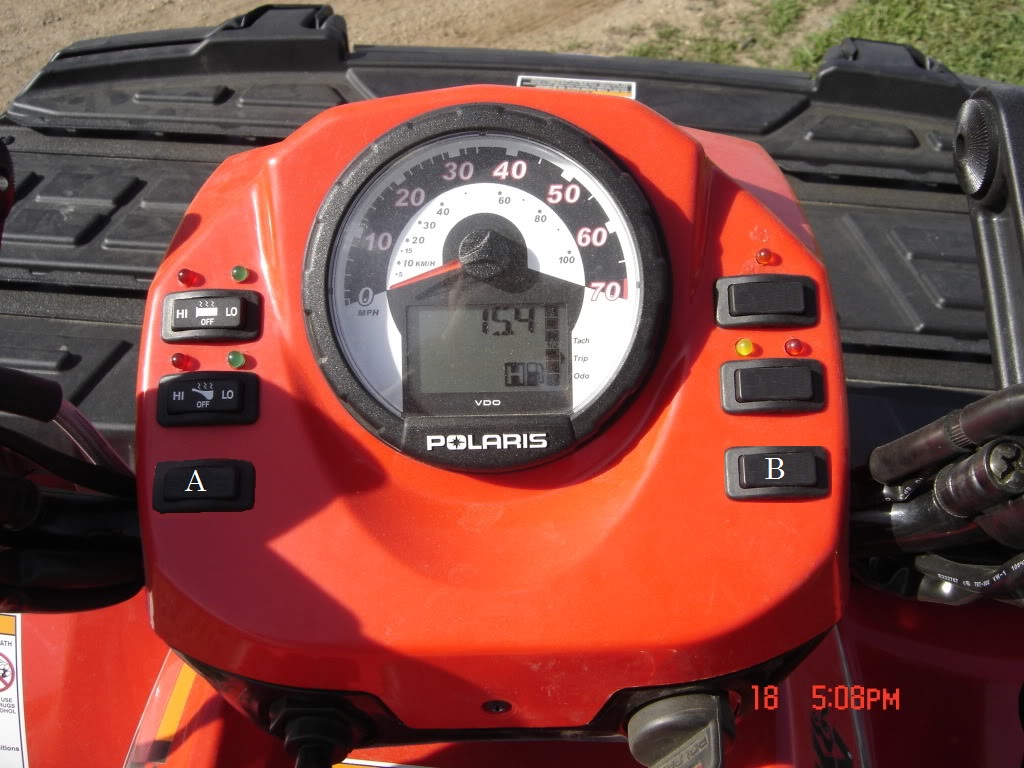

revised
ill add my switch right under the rest on my headlight pod. in either the "A" or "b" spot
