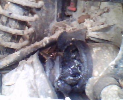

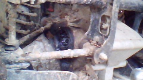

The CV joint has been clicking all the time, and I was wondering if this could be the solution? POLARIS Sportsman 335 400 500 Inner CV Joint Kit 99-07 : eBay Motors (item 160417737568 end time Apr-25-10 18:43:04 PDT)
Here are some pics of the problem: CV boot repair-cv.boot.jpg
P.S. The ATV is a Polaris 2002 Sportsman 400. Thanks!

Yeah CV joints tend to click when they get bad and with a torn boot their time is limited. (Although yours doesn't look like it has been torn too long - or you have been greasing it)
You could pull it all apart and just do the inner CV joint but (IMO) the best thing to do would be a complete new shaft assemby because it is a 8 year old machine. When you look at the cost of the shaft assy it makes sense. All new everything and pre-assembled.

If you look again on Ebay for cvman's store, he is selling the COMPLETE axle, ready to run, for $60.00. I just got one for my 01 500HO.

But will the one that I posted still work?

Yeah it should definately work. I don't see any reason why not.
BUT FOR $60 LIKE PWSSR INDICATES.........
