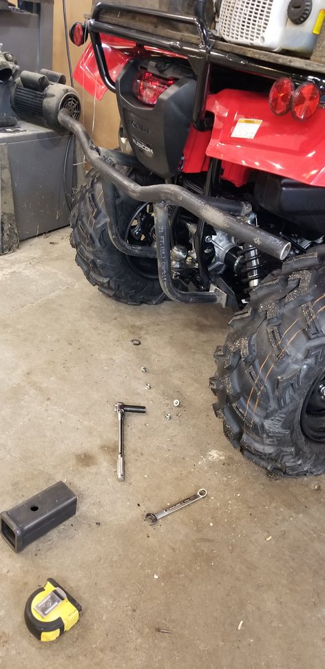

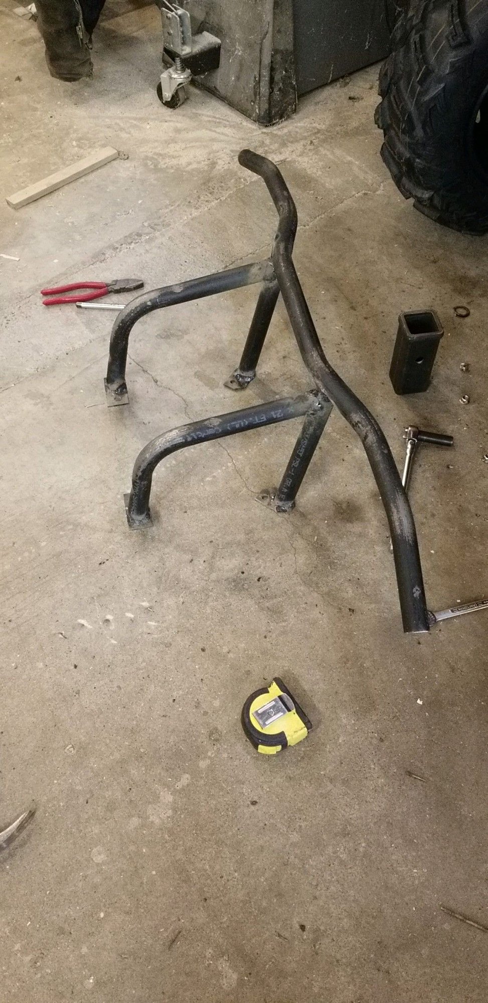

Originally Posted by james [b
rear cradle for bumper, winch, and reciever. Just started yesterday. Keep winch high and protected. I made one similar for 700 grizzly.[/b]
