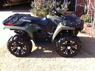

I think you will be fine for sure with the 27". 28", not sure. My brother-in-law just did 27" Mudlites and 14" ITP on his 500 and they fit fine. You will probably be fine either way as long as the wheel you buy has enough offset. You wont even need to stiffen you springs at all. Another guys on polarisatvforums.com fit 30" silverbacks on his 850 with no rubbing (he did crank his springs), so you should be fine either way. If if it gives you any trouble, wheels spacers is another option.
Here's my '05 400cc with 26" Zillas:
And here's mine again and his '10 500 with the 27" Mudlites, no rubbing at all.
