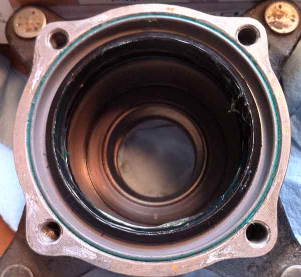

I got a hold of the service manual, but it doesn't cover how to replace this sleeve. After looking at it closer, I'm not sure how you get a punch behind that sleeve to tap it out... seems that the strut is in way. Do you just cut the silicone out and wedge a wedge punch/screwdriver between the edge of the sleeve and the strut housing and pry it out? Service manual also doesn't cover the alignment/tolerance well.
I also looked for some online videos showing someone replacing this sleeve - no luck.
Debating on whether I keep going, or just put it back together w/o the seal and take it to (another) dealer to do.
Update: I managed to get the sleeve off with a couple small chisels and a lot of time. Took me about 2 hours to tap it out & clean up all of the old silicone off of the strut casting. It was a PITA since the strut is in the way for a large part of the circumference, making for a less than ideal tapping angle in many spots... but it's out. A couple small nicks in the casting, should be fine with silicone. I'd challenge anyone else to get it off w/ less damage, short of having something like a specialized harmonic balancer/pulley puller.

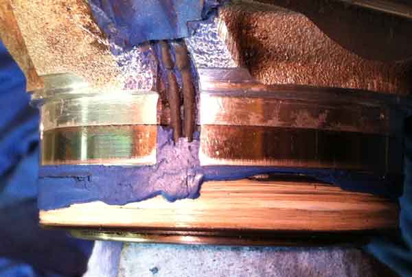

1) I cleaned up the strut casting well (old silicone), but should I remove & replace the silicone from that white coil too? Or is it OK to leave it as you see it (guessing - yes), and I'll re-silicone the entire backside (strut casting) when I put the new one on?
2) Should I just use the normal, blue silicone available from any automotive store? There's nothing special here? carb/break cleaner the strut casting surface before siliconing? (or should I not be worried that the hub fluid exposure may keep the silicone from bonding?)
3) I was very careful around the coil wires - 100% positive I didn't nic them. That said, is there any easy way to test the coil before I put the new sleeve on? Can I just turn the key on, 4WD button on, and see if it's magnetized?
4) White lithium grease between the inner lip of the new hub seal and this new sleeve, right?

Yes to all questions except #1. Just leave the old silicone on the coil wires and use plenty of blue to go over the casting.Be sure to clean any that seeps at the front of the sleeve into the coil face.Looks like a clean job!! If the armature plate pulls to the coil in awd mode you're ok. Plus yes again it's hard to keep from getting a couple nicks in the casting when removing the old sleeve and I challenge anyone to keep from doing so too

Last night, I installed the new sleeve. It was pain, but could have been worse. Problem #1 was that I didn't have a 0.001 feeler gauge (0.002 was the smallest I had), and the smallest my local auto parts store had was 0.0015. So I bought and used that, and just made sure it tighter than that. Other than that, just took a lot of time/patience, and an extra set of hands to help with lighting and holding the axle out the way while I was measuring clearances. In hindsight, I would have used a little more silicone on it. Should be fine. After the final tapping, checked the clearances like 50x just to make sure.

Looks good enough! Especially the hub seal and how it's flush with the casting. Looks like you have enough silicone. The sleeve will push back a lot of it when you install it,but there's usually enough of a film to hold the sleeve in place,plus it's a tight fit to begin with. Keep us updated on the progress..
