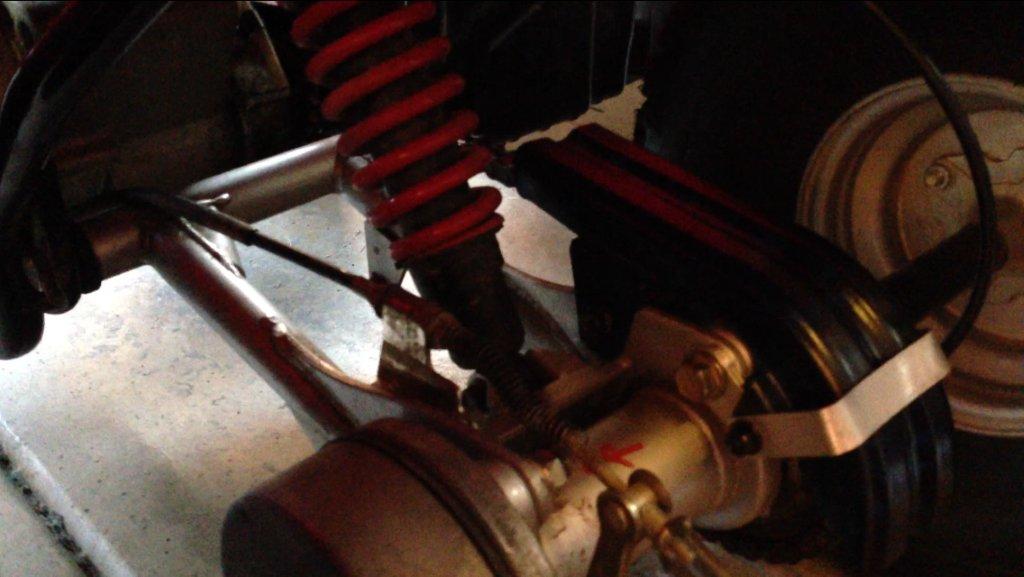

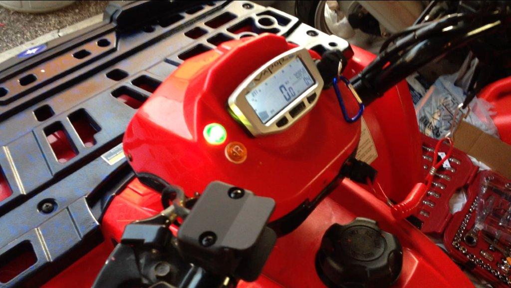

This machine is really coming along. Just finished installing a Trail Tech Vapor speedometer on my daughters Polaris 90. I really think most youth quads should have a working speedometer. It is really cheesy having a sicker with pretend speedometer on it. It reminds me of one of those electric Power Wheels. These are $2000+ machines!! They should know how fast they are going. Took some minor fab work on the rear end to mount the magnet and sensor. It is wired to the ignition, and turns on when the key is turned. It has a RPM sensor, and engine temp also. This kit came with in-line coolant sensor. I need to purchase one that attaches to the spark plug. For now the Vapor only reads the ambient temp. The speedometer and RPM’s work great!

If this is like the trail tech I had, I think it will show the top speed too. Be kinda handy if you tell them to take it easy.
Good looking job on the install.

Your right OPT! I even catch myself looking down at the speedometer on flat terrain. Both my girls are pretty seasoned riders, been riding for over 4 years (9 and 14). I installed one on this Polaris 90, and one on my other daughter’s 2003 Recon 250. I am using this more of a training tool. I want them to get used to speed as it relates to MPH. For the most part we do trail riding, where you are focused on the person in front of you and the obstacles ahead. The more mud and water the better for our family. For us as a family, there is no reason anyone should be going above 20mph.
