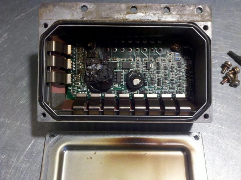

Easiest way is with a good battery just check what it's charging at the battery terminals at an idle. Should be at least 14 volts. If not,then most likely the ecm. Here's a pic from a member that had the updated style USA made Sure Power ecm that melted inside. Doesn't matter if they're Chinese like the original ecms or USA made,they all can fail.

I checks the volts at the battery with the machine off and it read just under 13. With the machine on the volts never really moved they stayed under 13 at idle and at a higher rpm. So I guess Iam gonna replace the ecm for sure. Just hesitant on throwing $200 in parts at it without knowing 100% that is/was the problem.... Thanks for your help!!!

it did turn out to be the ecm. swapped it out for a new one and all is good
