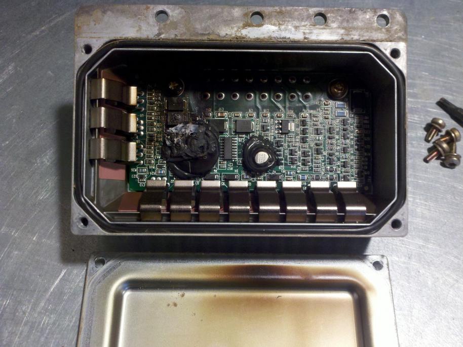

Old May 5, 2014 | 01:51 PM
No hopefully not in flames,but can just melt like this good American made module did..
Thanks for the picture OPT. You know the weird part about the battery flashing on my ATV is that it does not do it in neutral no matter the RPM. But it does it almost exclusively under acceleration. It blinks, then stops when I come to a standstill. Charging rates seems a-ok. No overcharge, no undercharge. Maybe the battery connections or a loose connection or ground. I do have a battery tender lead hooked up to it as well. Never really liked the fact that the ring terminals have much bigger hole than necessary for the terminal bolts. Never really felt you could get the leads tight. They are a major convenience though. Might remove it and try it again. Battery looks like its been through a war (Sealed unit)...which is pretty weird in itself. Don't know how old it is so I may just get a new one just to eliminate that possibility.
