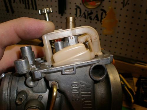

Upon reassembly , I set the fuel mixture screw to 2 turns out because that's what it was set at when I originally checked it. (The manual says 2.5) I replaced the main and pilot jet with the same ones that it had (stock) ,new bowl gasket and fuel needle jet spring. New float needle and seat. I also adjusted the float a little so it would "lower" the fuel level. I installed a new spark plug and set the valves.
What could have happened to give me such poor idle control now and why is fuel leaking out the drain hose when I have a new needle and seat?

Hard carb to keep gas from seeping out of the over flow hose because of the float system design. I've even experimented with different o-rings for the needle and seat to see if it helps and also with the float tab as you have,but for the most part if you have this float adjusted as the diagram shows leaking will stop or at least slow down a tad. Plus I'd retrace your steps. Here's a BST40 Mikuni similar to yours on a Ktm.The BST-40 Bible - ADVrider

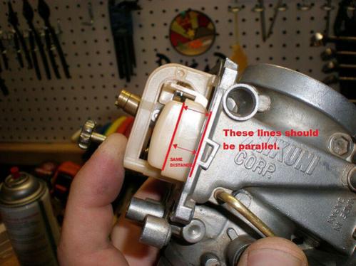

Holding the carb upside down allows the full weight of the float to press the small needle plunger all the way down along with the needle valve itself. Turn the carb side ways to where the float tab BARELY touches the small needle valve plunger. At this angle the float seam should line up parallel with the carb base.If off,adjust the float tab to where it is.. Here's what it looks like with it close to being upside down.. P.S. you have to hold the float assy bar with your finger like shown in the pictures tight to simulate the bowl pressure when assembled..
ok......I'm still a little fuzzy on that adjustment but will attempt it on my next days off which will be next week. What are you simulating when the carb is tilted a little sideways when having to adjust the float tang? Is that where the fuel would stop coming in? What position is the float when in use and engine running? Would it be level with the carb bowl seam if we could see inside ?

All you're doing is setting the float height to where it's just beginning to shut the fuel off. When the carb is assembled and the float is upside down,when the bowl fills with fuel, the float rises and shuts the fuel off. The float then should almost be parallel with the bottom of the carb bowl just like it was when you held it sideways to adjust it..

When assembled,the float falls all the way down. When fuel enters the bowl the fuel raises the float which gradually pushes the float needle up into the valve until it shuts the fuel off.This level should be a little less than the top of the fuel bowl and the small brass over flow tube that drains at the bottom of the carb if it does.. Go look at your toilet bowl if it has a float arm system. Same principle when the water shuts off..
