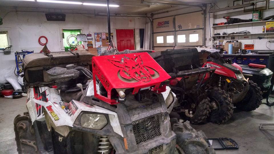

Thanks for the replies everyone! Checked SPAL and they don't carry anything for the 1000 that I could find. Brand on mine is TRIPAC. Did some web searching and came up empty... Checked the site OPT gave and they're the same price. Just glad I figured out the problem now and did the Big Boar radiator relocate up on the front rack. Turned out pretty sweet! I get the dealer prices on some stuff and that's why the internet is a beautiful thing.
