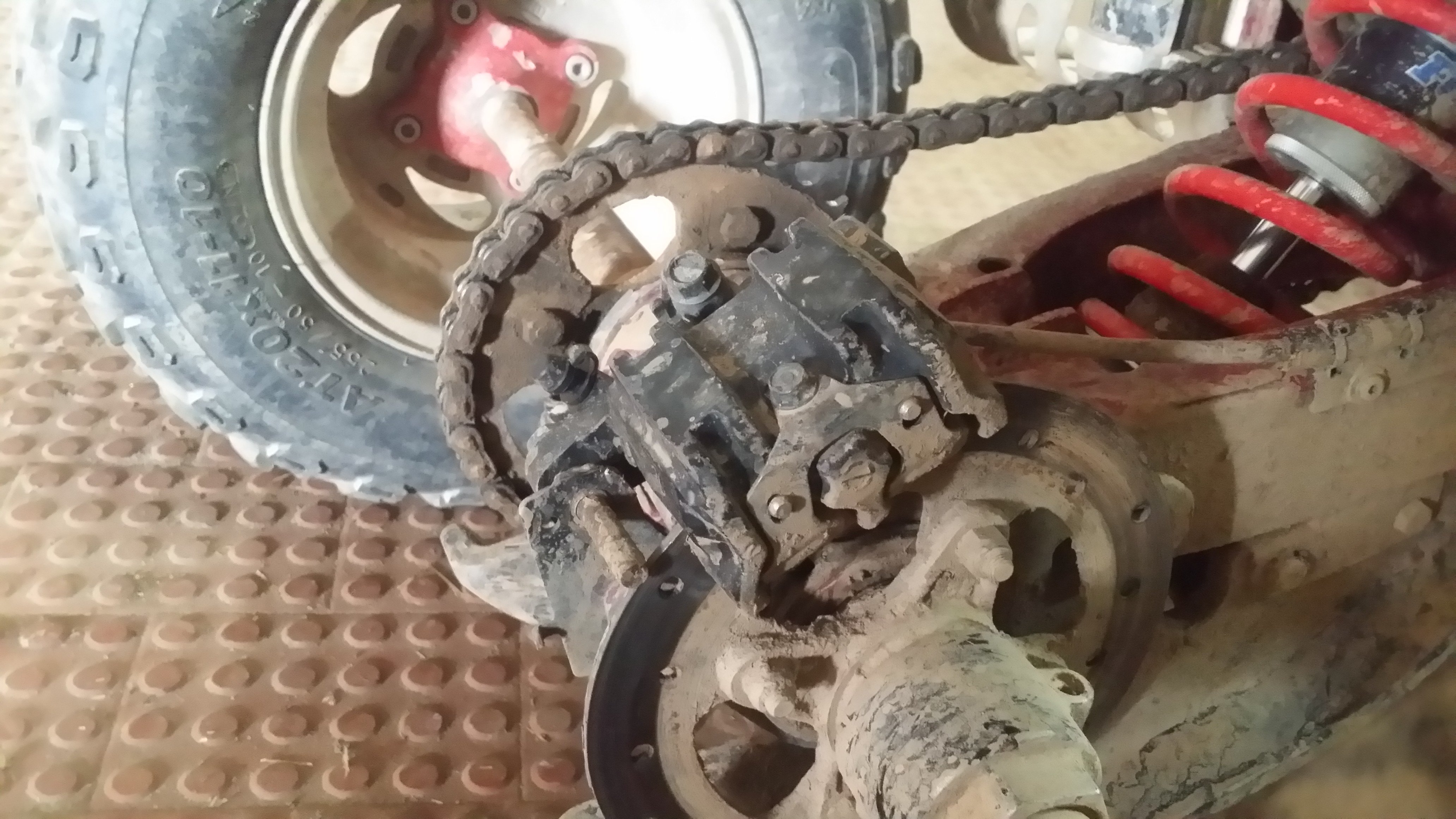

A friend of mine bought a Predator 500 recently. Nice bike, rides very good. Has a couple of extras. I ordered brake pads for it, but the rear pads donīt match the ones on the bike. every site i have looked, the front and the rear pads are the same. This bike has bigger, 2 piston caliper at the rear. What model does this come from? Maybe earlier Predator?
This one is believed to be a 2003. Canīt find the VIN number anywhere. Frame has been painted red. And it has a couple of underbelly protections also so if the number would be on the lower frame tube, it is hard to see. How do we determine the year of this bike? Where is he VIN supposed to be?
Also rear hubs are different than what i find online. He has the original hubs and wheels with it, the hubs have stripped the splines... These hubs are smaller, 4 studs, approximatly 3 1/16 inch apart.

Left lower frame behind the a-arm is where the 17 digit vin# is supposed to be. May be ground down? If you find it 10th digit is the year model. Shows to have the same caliper for the rear as the fronts. If you can't find pads for this thing,you might get a used caliper on ebay(if it's a 2003) T8533 Front Left Brake Caliper Polaris Predator Outlaw 500 2003 2007 1910689 | eBay Oil could be the problem,but only way to tell is drain it and replace with jaso rated oil. Any specific good synthetic will work or even oil such as Rotella T6 5w40.If it still slips,then probably needs new clutch plates.Plus who knows what hubs and wheels po may have installed. Here's a good place to find oem part numbers if needed.Dirt Cheap Yamaha, Polaris, Suzuki & Kawasaki OEM Parts & Accessories – Cycle Parts Warehouse Or the Polaris Parts Catalog. http://parts.polarisind.com/Browse/Browse.asp

So I changed the oil for JASO MA-2 spec oil. Can't say it to make much difference on the clutch but it was raining, couldn't accelerate very hard...
About the brake, could it be an aftermarket calliper? I found out the Outlaw 450S has dual piston front callipers but not the same as this.
Old Mar 18, 2016 | 05:18 PM
That's what I'm thinking, an aftermarket caliper. Thought possibly they were able to use the front caliper on the Outlaw also,but since you say it's different..
