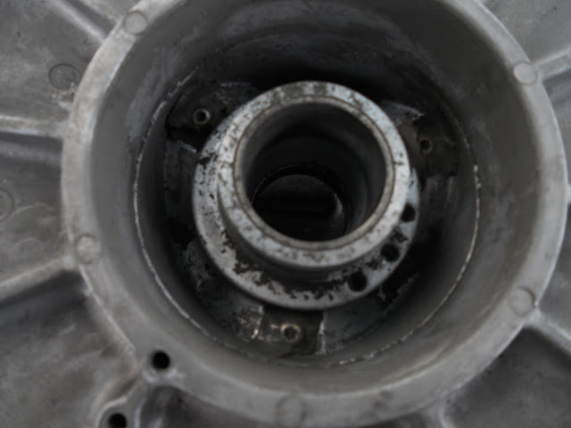

I recently bought a 00 sp500. It doesn't accelerate past 30 mph. I have read on here that it could be me clutches. I don't mind spending the money to buy the rebuild kits but I just don't want to throw money at it not knowing if that's the problem. Does anyone have pictures or video of worn buttons. I cant find any on YouTube and I'm not sure what to look for. I'm also wondering if there any other possibilities that cause this problem. Thanks!
Old Jun 14, 2016 | 03:59 AM
This what some of the worst ones look like when ground down versus new ones. The manual has step by step pictures on replacing them and also preloading the helix spring. That is if you have the non ebs system. The ebs has rollers that can do the same thing.Both were offered that year. Dirt Cheap Yamaha, Polaris, Suzuki & Kawasaki OEM Parts & Accessories – Cycle Parts Warehouse Having the manual is the best thing when you tackle any job like this.http://visit.tradebit.com/visit.php/...75/264163829/9
