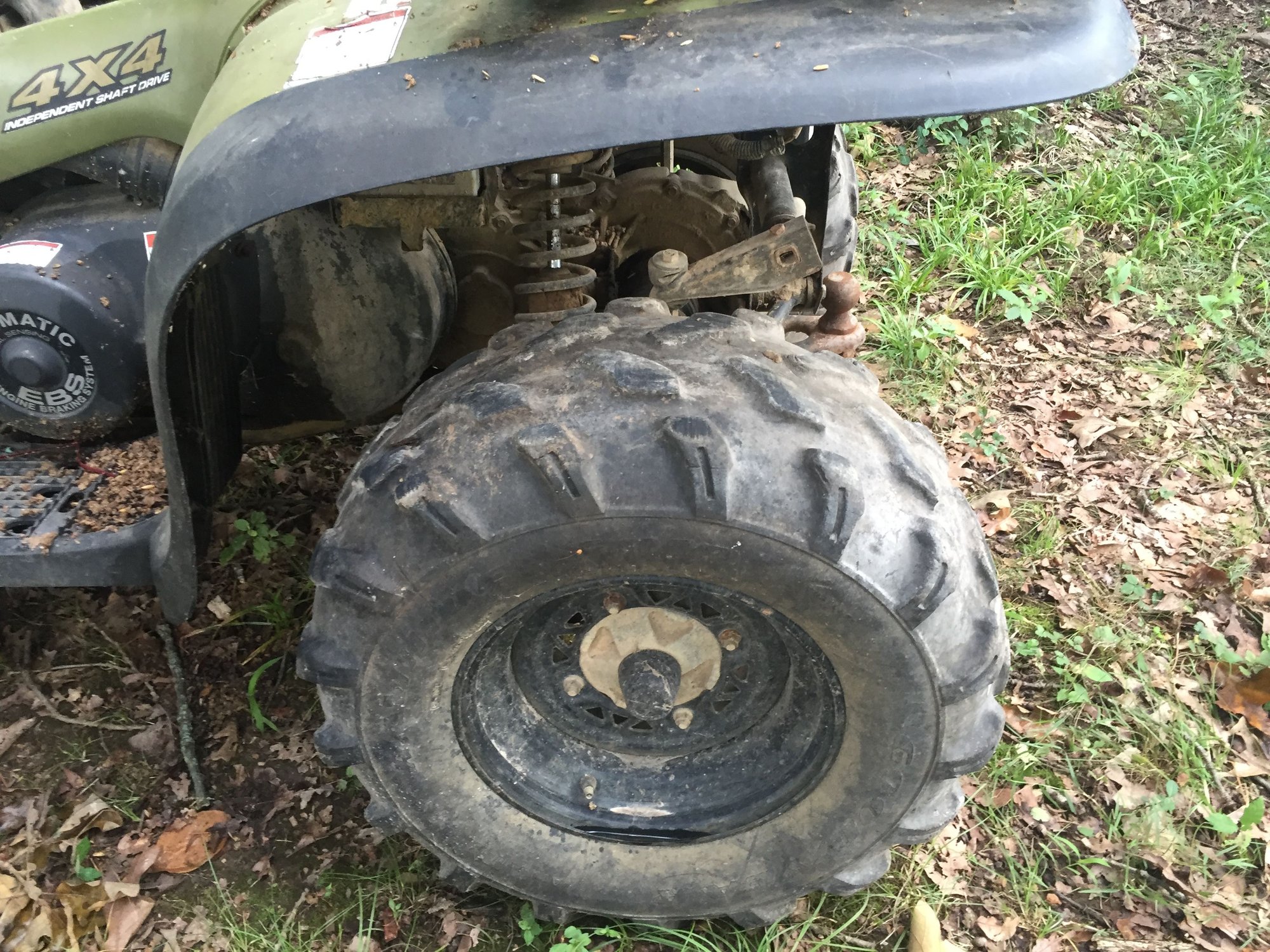

I recently rescued a 2000 Sportsman 500 from a neglectful PO, I bought it cheap as a winter project to use around our farm. It was not running. I washed it to see what I am dealing with as it was filthy and then started checking fluids and found zero oil on the dipstick to the trans.
Are these known to leak out? I will admit this ATV didn't look like it was well taken care of by the previous owner at all but I figured it would be worth a chance to refurb it as I got it really cheap. He parked it when the bendix came apart and busted the pull start case so he parked it for 2+ years. I have a new bendix and a used good case so I am going to start cleaning it up and putting it back together and will lube and change all the fluids to see what I am working with.
One thing to NOTE: When I washed it there was a oily dirt all over the left (Clutch cover side) of the machine. I don't think he ever washed this machine so it could be normal grime and dirt but with the missing trans fluid I figured I would mention it.
Advice???
