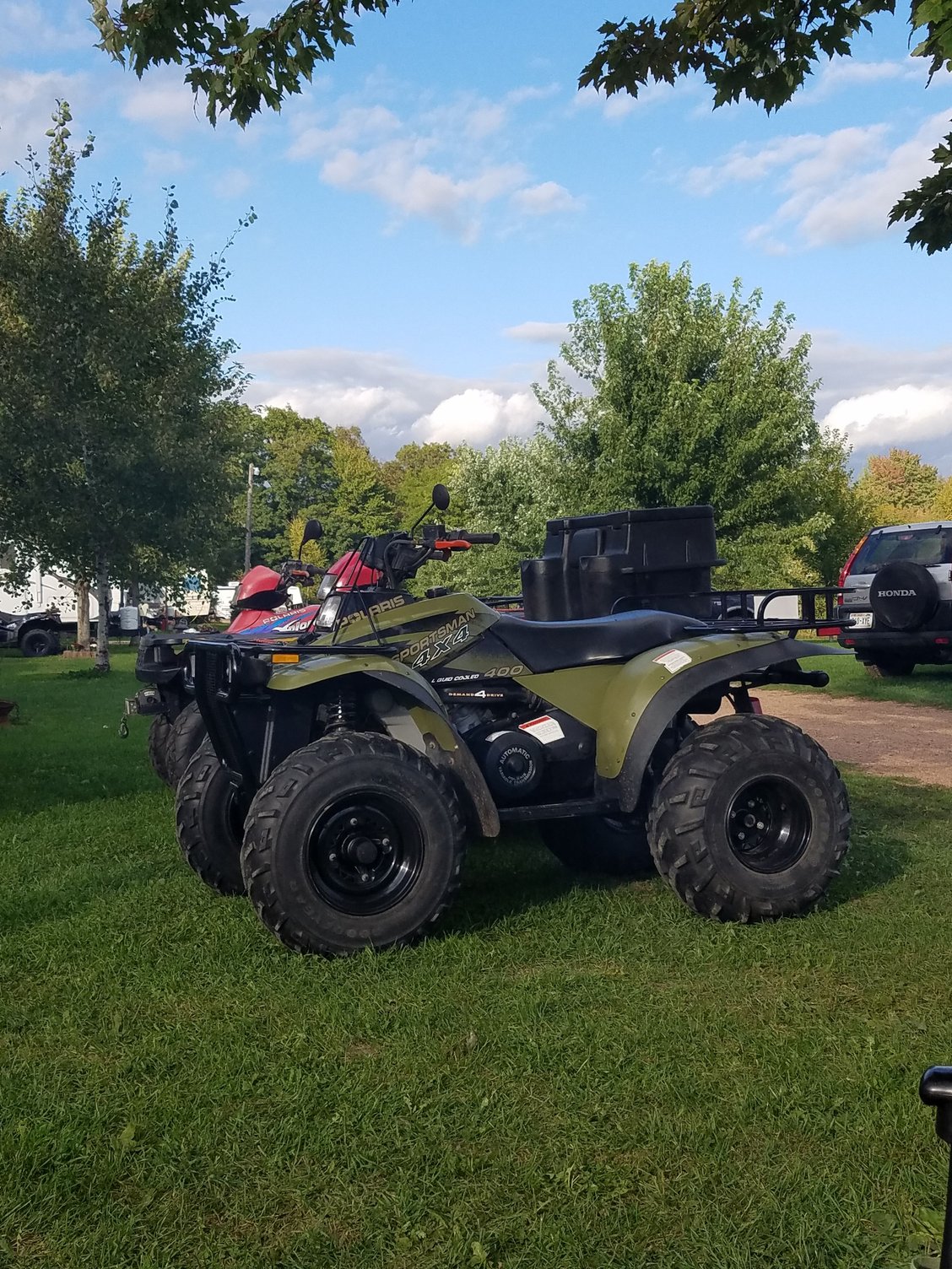

I got my 95 sportsman 400 all done and rode it quite a bit this weekend. Everything ran out good. One thing I did when I bought this machine was disconnect the reverse limiter. I noticed it would die as soon as I put it in reverse so I eliminated that issue by pulling the black wire. The only thing I notice now is, the AWD light does not light up in reverse unless I push the button on the limiter override. Does unhook ingredients the wire just eliminate the engine limiter or should it also override the AWD also? The four wheel drive works great, just want to make sure I don't have to unhook another wire.
Thanks,
Mike
