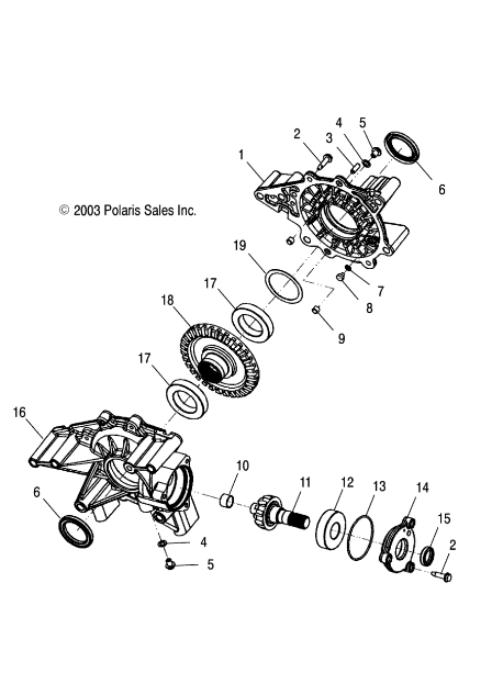

I've eliminated the noise to the transmission. I unhooked the rear prop shaft and front prop shaft. When I start it and put it in gear it makes a clanking in forward or reverse when I hit the gas. Any ideas what it could be and if it's fixable?
Old Oct 18, 2016 | 06:55 PM
Does the noise seem like it's coming from the rear gear case or drive shaft area?

I think it's coming from the rear of the transmission
Old Oct 18, 2016 | 07:15 PM
Could be the slider tracks in the plunging joint where the large ball bearings ride making the noise or could be one of the bearings that support the large drive gear in the gear case. I'd suspect the drive shaft if you kept up on rear gear case fluid changes. I know you mentioned play at the gear case but see if there is a lot of side to side play on the plunging joint by twisting the shaft.

I have the rear axles and rear diff removed. And unhooked the front prop shaft. And the noise sounds like it's coming from the transmission. I put it in gear and when I hit the gas it makes a snapping noise.
Old Oct 18, 2016 | 08:11 PM
Ok then have you pulled the outer shift cover and checked the inner quadrant like I posted that this guy did.Hard to Shift 700 Sportsman 2004 - Polaris ATV Forum Could be jumping into gear when you give it throttle. Plus don't over look the clutches that can cause problems and make noise also. If you rule these out then sounds like a main gear case internal problem.
