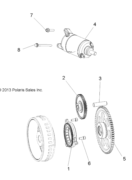

If it's still under warranty,have it looked at. It may not be the starter but could be a bad sprague clutch(one way clutch) or a starter gear making the noise. 2014 Polaris SPORTSMAN 570 EFI (A14MH57AA/AC/AD) Engine, Starter Drive | Cycle Parts Warehouse

That's what I'm thinking. But it's not under warranty so it looks like I'm tearing into myself.
