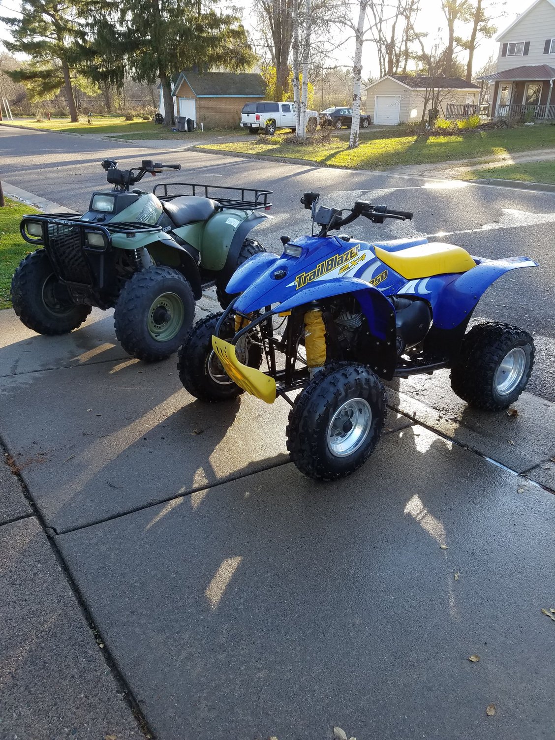

Got some time to finish putting the little 2002 trailblazer 250 back together. The last owner had the air filter box out of it and the exhaust cover off too. Found out where all the nut and bolts went and got it back together except for this piece of thin plastic. He said he took it off but couldn't remember where he took it off from, lol. I can't find a service manual online so I'm at a loss on where this goes. Got it all cleaned up and running like a top so I don't want to throw this away if it belongs on the machine.
Thanks,
Mike

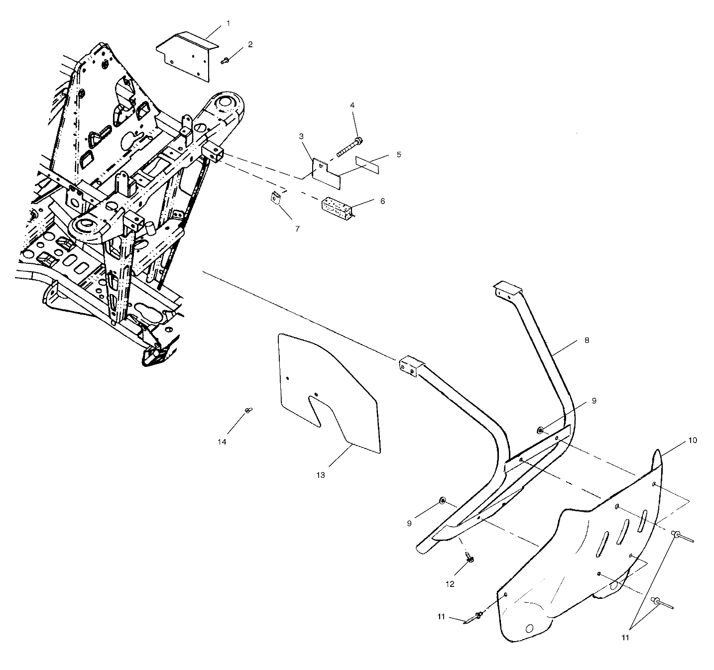

Looks like the piece your missing from the front right. Item#13.2002 Polaris TRAIL BLAZER (A02BA25CA/CD) Front Bumper & Shields A02ba25ca/Cb/Cd | Cycle Parts Warehouse Plus if this is the little atv you got for 400 bucks.. Should have one for the left and right. #1 isn't shown but listed.

Thanks OPT,
Must be a splash shield for the front steering components. Yes this is the 400 buck find.....Kids love it! Guess I will order the other side for it too.
