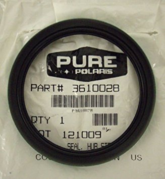

I found a set of aftermarket CVs that fit and I'm working on putting them in now. I'd be done already had I realized that I ordered a seal kit for the hubs only, and not also for the struts...

On another note, for the strut seal (on the back side, where the CV enters the strut), the OEM seal appears to be one larger seal, where as the aftermarket appears to use two thinner seals? Is this an acceptable alternative?
