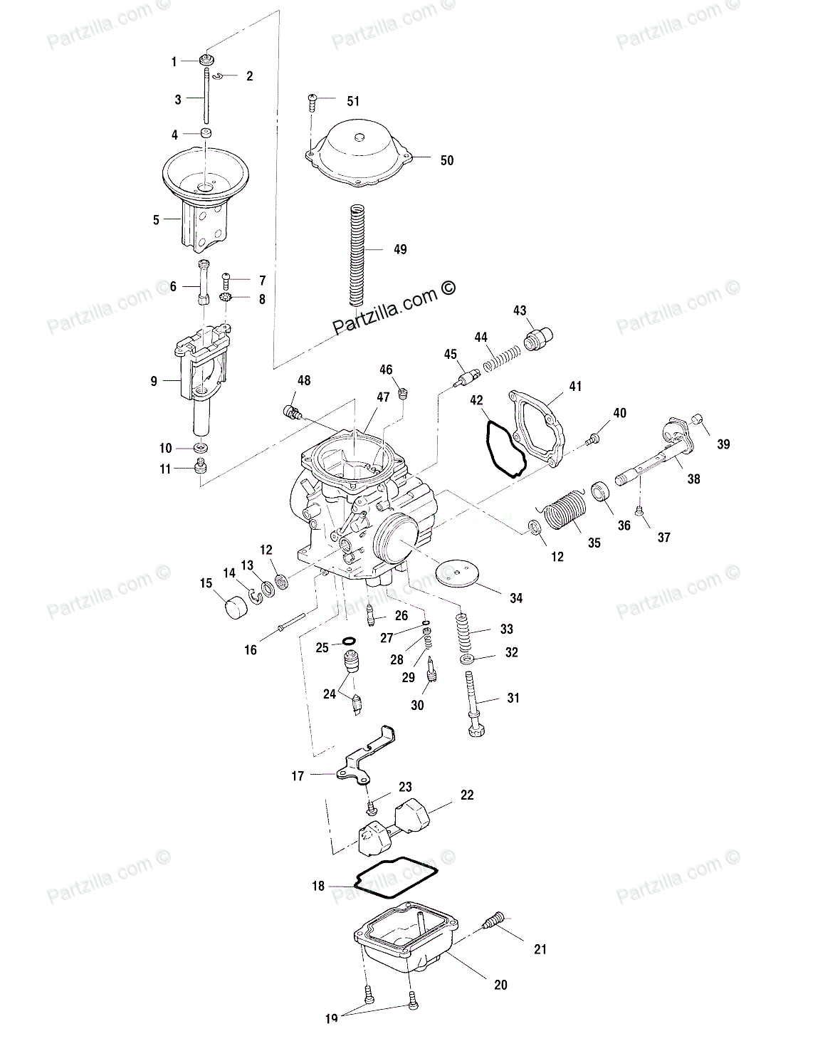

Carb jetting was close on both machines. 157.5 main jet on the Magnum,155 on the Sportsman. Is the air box and filter in place,if not that can be the problem. Plus pull the line from the carb and crank the engine over. Should be a steady or pulsing flow from the fuel pump.If these check out you may have to retrace your steps on the carb. Easy to get the small plastic parts holding the needle in place in the carb wrong also as some have done. I Know you've posted before but can't remember if you checked the exhaust lobe on the cam also for wear or scoring.

Make sure all passages are blown out and you can see daylight through the jets. Also if you didn't thoroughly clean the needle jet when cleaning the carb,it can cause problems as it has a lot of small holes that need to be open.Item #6. Look at the slide needle and plastic spacers also to see if they are installed correctly.
