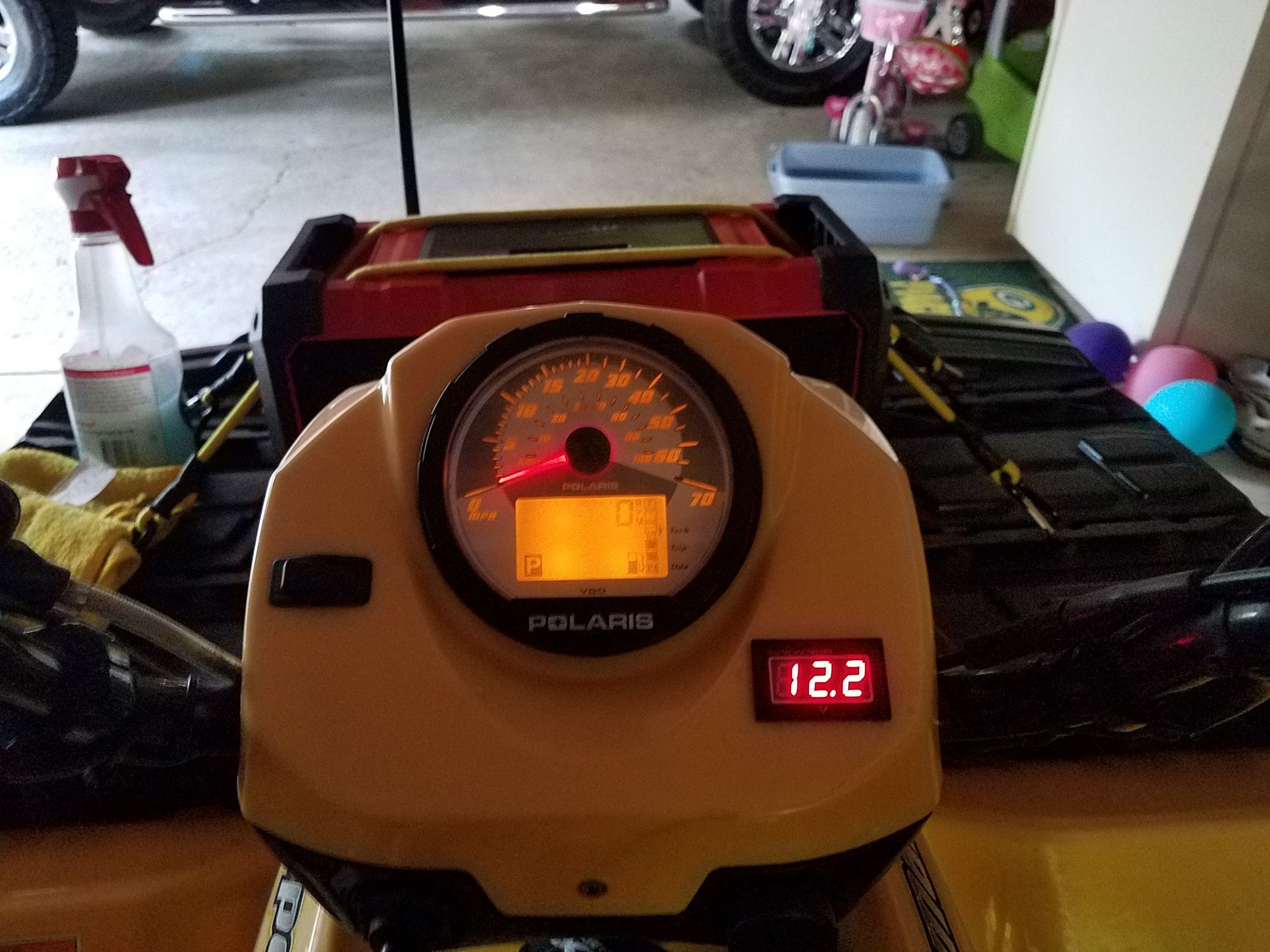

Have you checked the voltage again? It should be charging around 14 volts when it's running, not 15.5.

Powerranger262's Avatar
Joined: Aug 2017
Posts: 290
Likes: 8
Key on.
Running.
Old Jun 7, 2018 | 11:52 PM
  #37
user493's Avatar
Moto Psycho
Joined: May 2008
Posts: 8,747
From: Michigan
Looks good enough to me. 12 volt batteries are roughly 12.6 volts when they're fully charged. They have 6 cells that are 2.1 volts each, give or take a little. If it starts okay that's all that ever matters to me. The original 6 year(?) battery in my truck lasted 10 years but finally crapped out in the winter. Not enough cold cold cranking amps. My ATV is overdue for a new battery but I'm just keeping my eye on it for now. Sitting there not running for several months drained it and I haven't fully charged it yet. 14.4 volts while it's running is okay but it's toward the high end.
