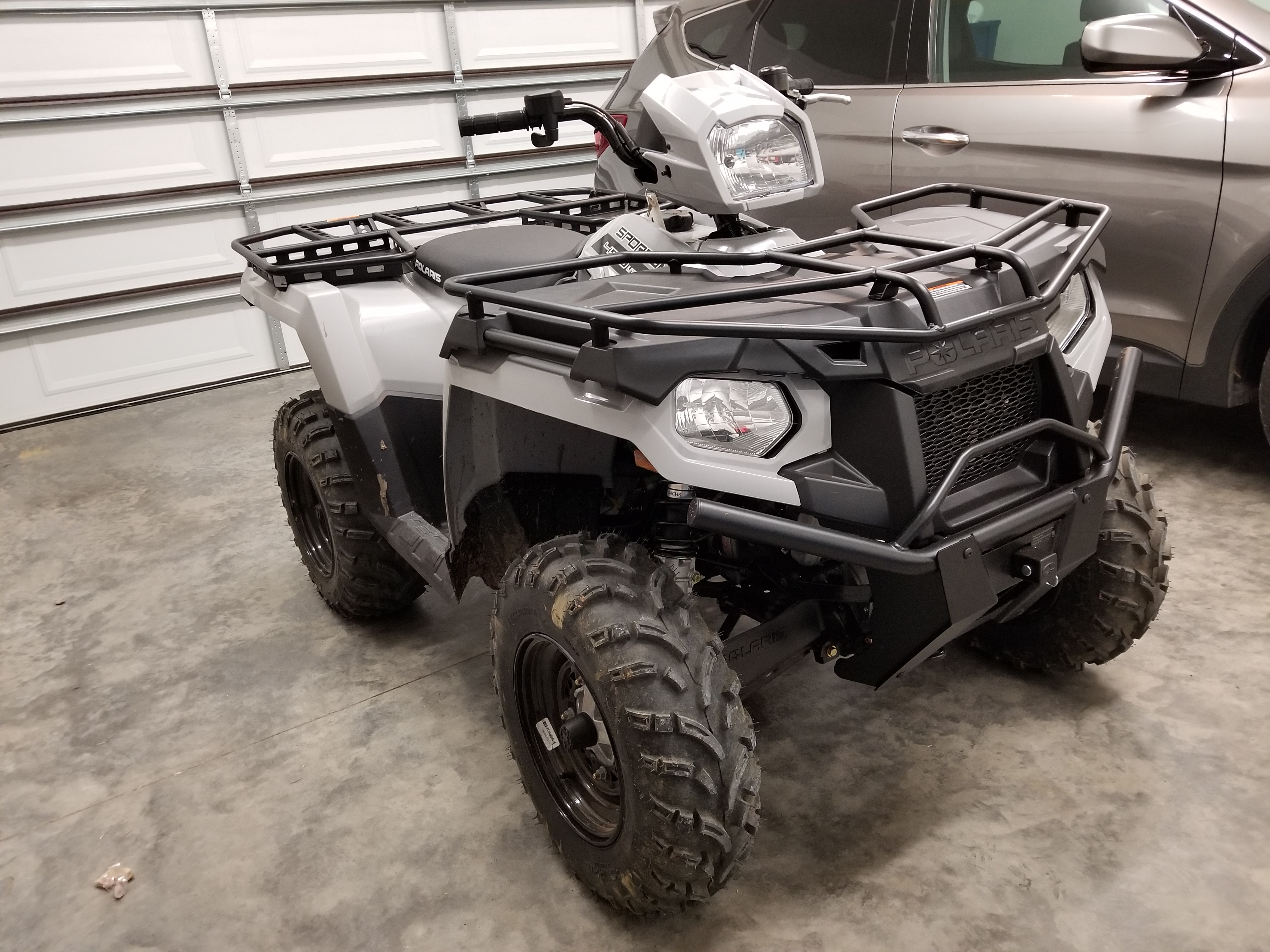

Just picked up a 2018 Polaris sportsman 450 Utility Edition. I'm looking for a winch for it. I have only had 1 atv and that was about 15 years ago and it did not have a winch, so I have no clue where to start. Looking for a 2500-3500 lb based on what I've read but want a pretty decent one that isn't super expensive. Also, what mounting bracket would I need and how hard is it to put on? I've installed quite a bit of stuff on cars, but never any atv stuff. Thanks in advance!
