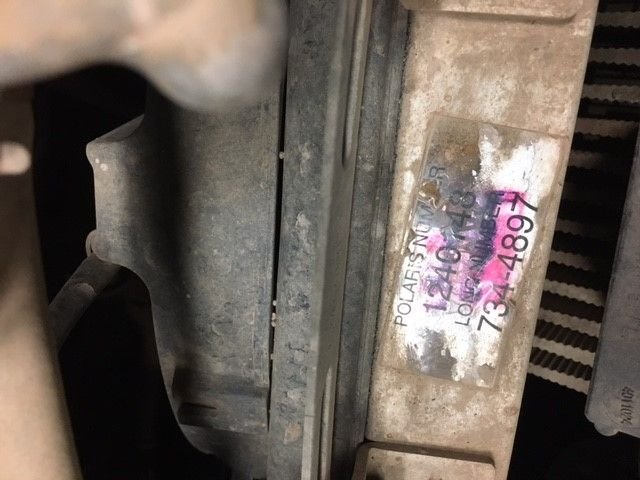

i'll throw out another anomaly here...... the radiator still has the Polaris part number. #1240148 which does not show up in the service parts lists anywhere.????

You've replaced the sensor(4010161) but can't remember where it's located? Or did you have a dealer replaced it and just can't find it? Either way the fan sensor is in one of two places. As you're facing the radiator,far left at the bottom,hidden by the fan shield. Even the sensor wiring is covered by a lip on the shield.I've had to snip a little of the plastic shield to replace them rather than remove the whole fan shield. Either it's there or the ONLY other place that fan sensors have been placed is on the far right side of the radiator,down towards the middle. Plus I'm like you on the radiator.. No listing for it.
