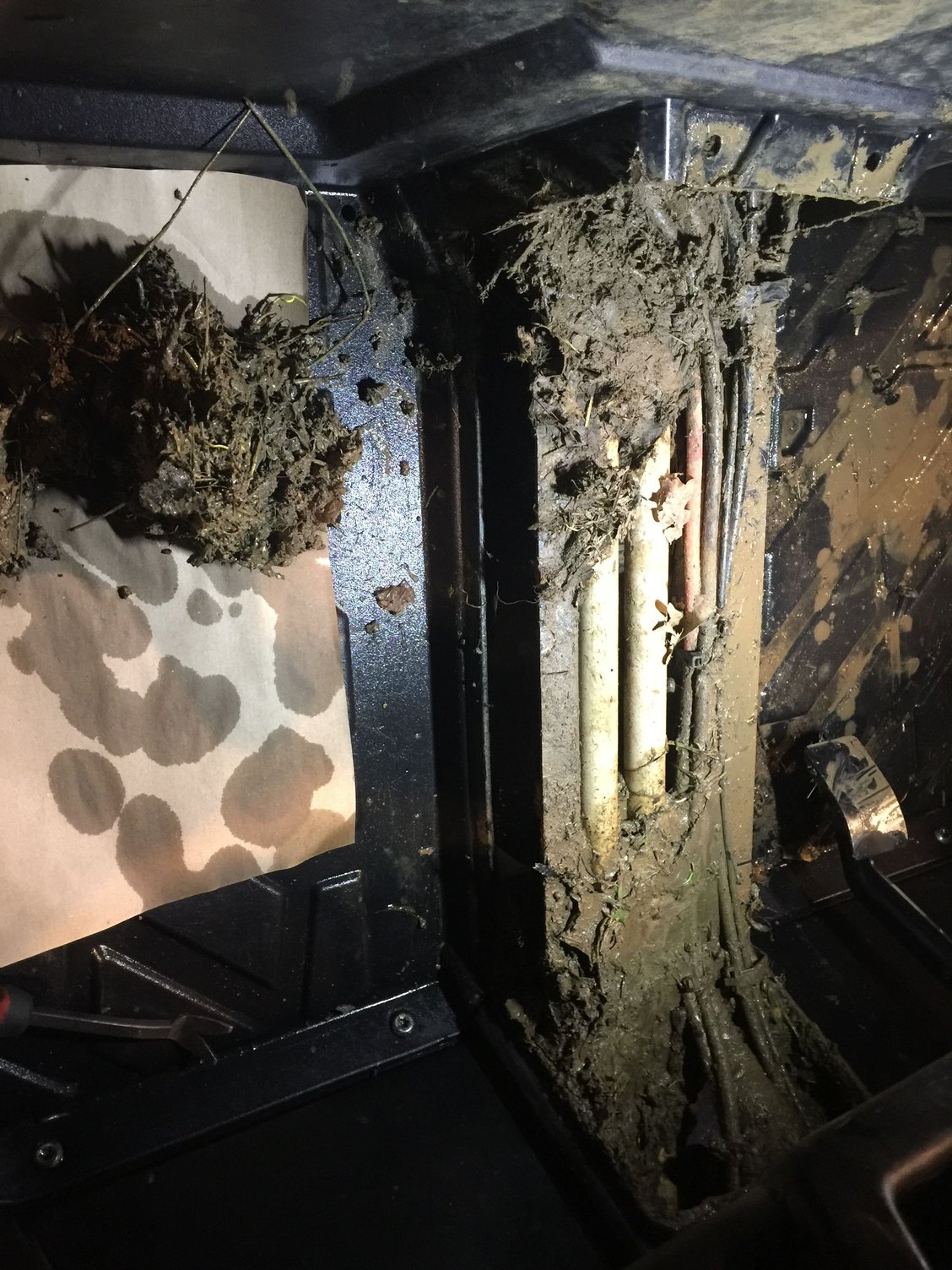

Got a Polaris Ranger here in the UK with a broken accelerator cable.. no big deal after I had a dig round & found it!. Is it common for this amount of mud to get wedged in the transmission tunnel & bury everything?🤔

Yes on some models the transmission tunnel can be a catch all for mud,branches and sometimes critters and their nests.
Your not joking! Next issue is figure out how to get the cable off the throttle pedal. Looks like most of the front has to come off. What were the designers thinking?!🤔
