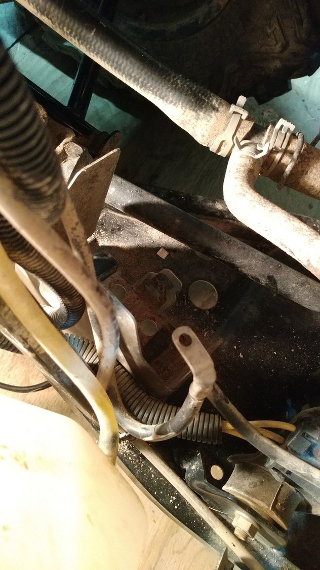

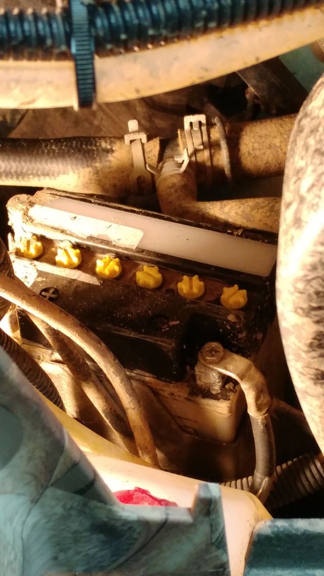

Sorry for my rant but heres some tips I learned. From right side disconnect rubber bungie cord fastner. Then pop off top black protective cover.
A Youtube video showed removing the battery metal compartment flange to remove battery. Not necessary at least on 2016 model. Must remove white Antifreeze-Coolent reserviour (left side ) to get the reach to negative batter terminal cable first before removing postice battery terminal cable and pop off the left side panel above left foot well.
Its a real pain literally, back wrenching, knuckle busting just to loosen the terminal screws. I recommend shorter phillips head screw driver Vs. Socket, its just too tedious. Its tricky maneuvering the battery out and new end. I had to in a clunky twisted back position funnel my hands between tire and footwell and left cover panel opening thru the EBS snorkel hole lifting heaving battery with fingerctips. Its a fanagle task to say the Least and then... New battery OEM YUSA had those stupid square nuts you have to insert in terminal whole allrhe while trying to get the screw thru it as it slides and falls out.
Total replacement/install time = 2 hours. Longer than that considering right tools for the job and figuring out. I suppose having a lift table and left wheel off may have made things smoother.
Disappointed in this new battery location design, SMH. Should not be that difficult and frustrating!
Heres some pics of my fun night, lol..lol
