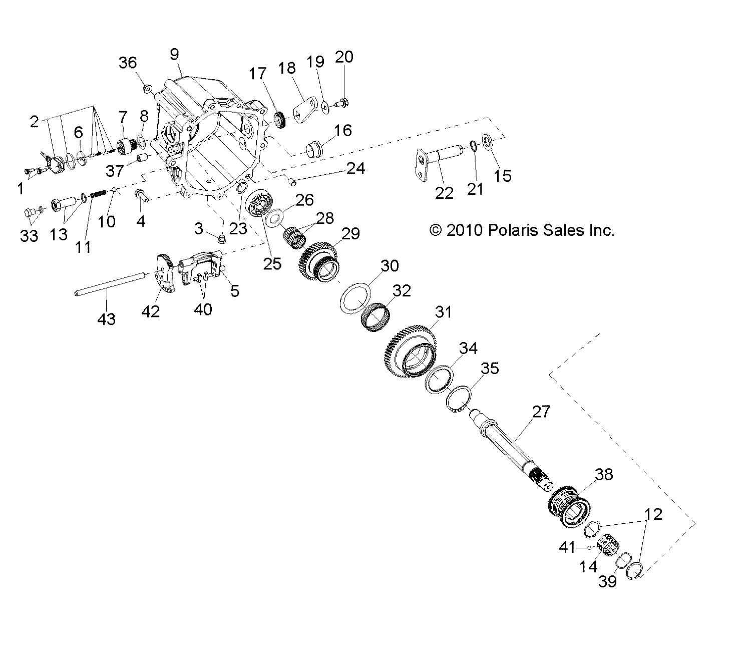

As far as erratic gear position check the wiring on the switch on the gear case.Item #2. On the noise? Could be from the brake rotor or pads if worn or noise may be from elsewhere.You may be able to jack the rear end up and check while it's running. Again tat's something you'll have to find and don't forget the manual if you're not sure. Plenty of tests and trouble shooting info.
