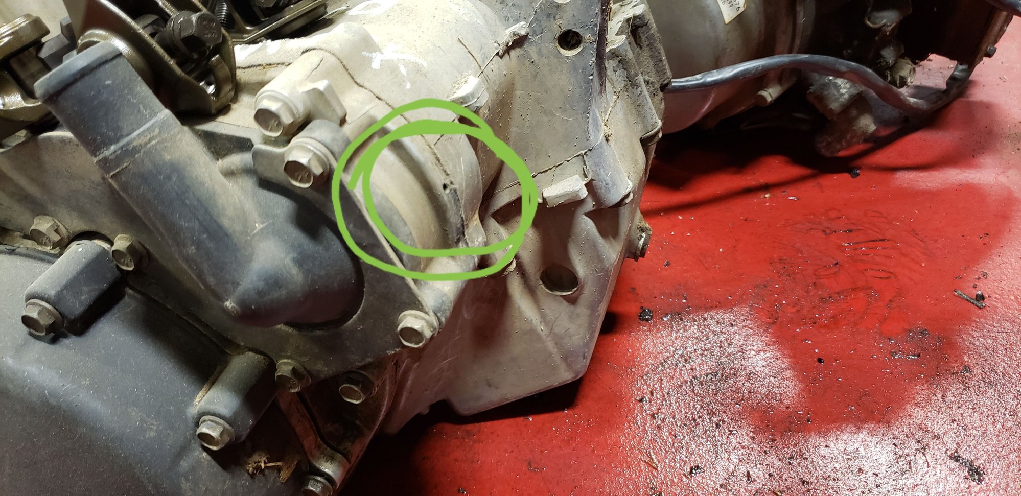

More problems I noticed today I had a little antifreeze leak after running the machine I replaced fuel pump and regulator today but I didn't get to test fuel pressure the new pump has a better sound to it.
Anyway after I let it run a bit I noticed coolant in the floor the only place I could see it come from was the bottom most bolt on the water pump cover it didn't really look like it was coming from between the cover and gasket just a drop at a time on the bolt head. If the pump goes bad is this bolt designed to leak someway like a weep hole I couldn't find a weep elsewhere.

Here is where the water pump weep hole is. I hope it is visible on the forum. One other thing is this motor is sitting on the floor and not oriented the same way it sits in the frame.

Thanks Harley. Its been few days since I've been on here been waiting on parts and then time to put them on. I replaced the fuel pump and regulator first and sprayed out the throttle body it sounded and ran better idle was right on 1180 after that. About that same time I noticed an anti freeze leak so I replaced the water pump seal an oil seal also replaced the t bab boot if that's what its called [the boot between the breather box and the throttle body] fuel filter and both exhaust donut gaskets now the idle is low 1120 rpm it also has a miss just kind of a dead spot when its at idle but runs much better down the drive and is much more responsive.
