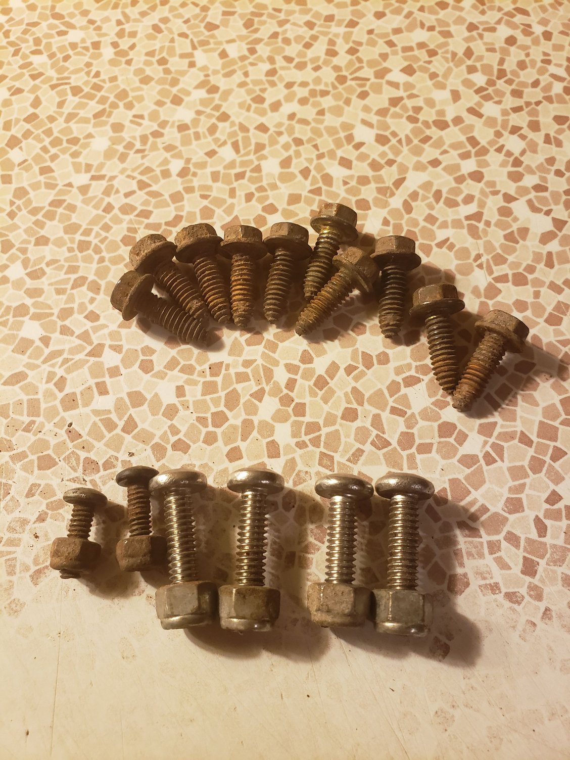

Just got done putting a rebuilt engine in my 99 300. I had some other items I wanted to work on, so removed most of my plastics. I took some photos of the screws for the fenders, footwell with nuts and front screws for front rack. I would also recommend downloading a parts manual. I found this right on the Polaris website. Not the exact year, but I think 96-99 300s are pretty much the same. Let me know of you have any other questions.

Sorry for the delay, meant to have my quad back together this weekend but ended up having to replace the petcock and fuel lines, so am a little behind where I thought I'd be. For starters, I can get you going on the mud guards screws. There are 6 screws on each side, these use a common screw used throughout the bike. You have two on yours I can see on your photo holding down the gas tank support, they are part #7512232, holding down part # 5220916-067. Hopefully this gets you started. Once you have the manual, if you want to provide the page #, I can try to provide a photo along with the length and width of the fastener.

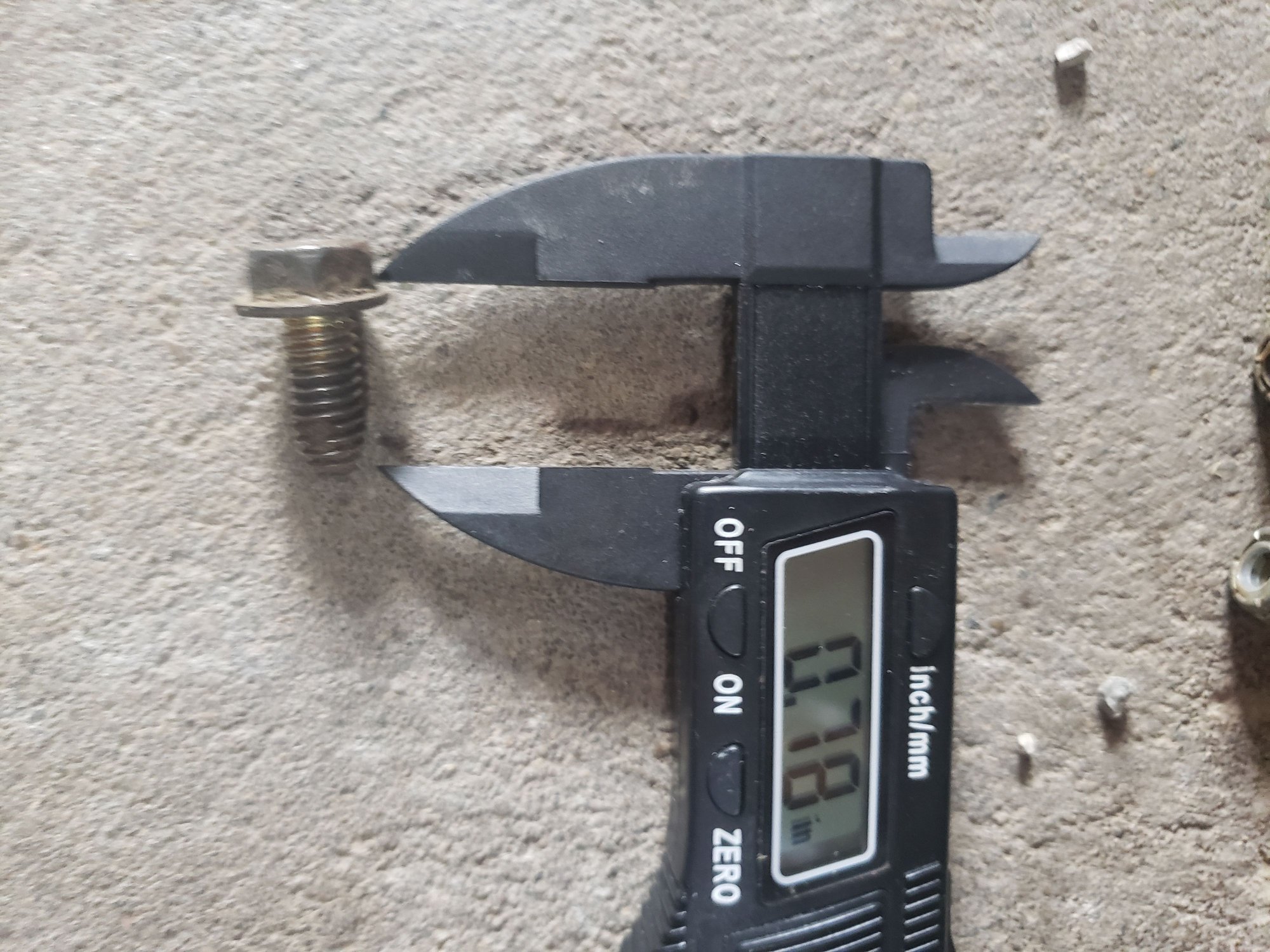

Sorry, I'm going to blame this one on the pandemic. The foot wells are simple 1 inch by 1/4 screws. My originals were rusted so I used stainless with unlock nuts. I think the originals had larger/flatter heads. The front took two 3/4 by 5/16
Footwell screws/nuts. These were aftermarket, i used stainless as my originals were rusted. 1" x 1/4" with nylock bolts.
Front bumper with original and winch kit bolt installed (partial).
Front bumper 5/16"
Front bumper 3/4" x 5/16"
(I think, caliper showing .29"), see photo. I have a whinch, so the silver bolt was from the whinch kit, tapered, short bolt original.
