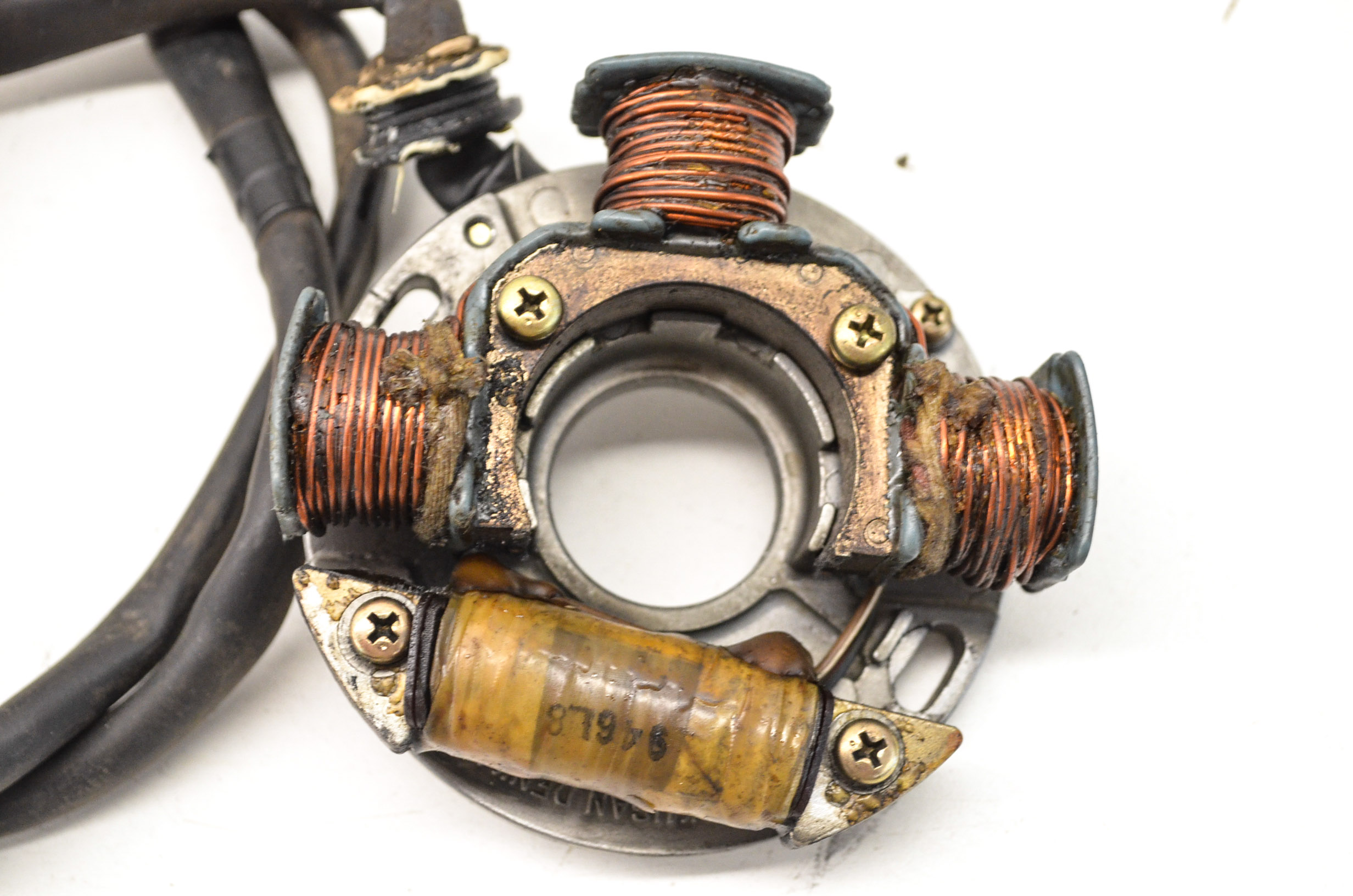

You say tab I say live lead, and I'm trying to locate where the brown/white meets the black/red (I'm assuming the brown/white is the one coming out of the cdi and going somewhere near the back of the bike)
The black/red to brown/white are from the stator that plug into the cdi module and are the exciter leads that trigger spark to the cdi.

Pull the connector apart. Check ohm readings on the black/red and brown/white wire that lead down to the stator... The stator is where your finger is pointing. Plus you have a leaking oil pump line somewhere..

You want me to test (at the harness) blk/red to brn/white coming from the stator. Got it now, that reads 123.x

Have had many people ask for that,I answer here only.. Stator exciter coil shows within range (123 ohms) so you can rule the stator exciter coil out. Since you've tried TWO ignition coils,pulled the black kill wire from the cdi to eliminate a kill circuit short,then the only thing else is to pull the black wire from the reverse over ride module to see if it's causing spark loss. If you still don't have spark after that then I have to "assume" you need another cdi module. Item#27 is the reverse over ride module located next to the regulator.Dirt Cheap Yamaha, Polaris, Suzuki & Kawasaki OEM Parts & Accessories – Cycle Parts Warehouse
