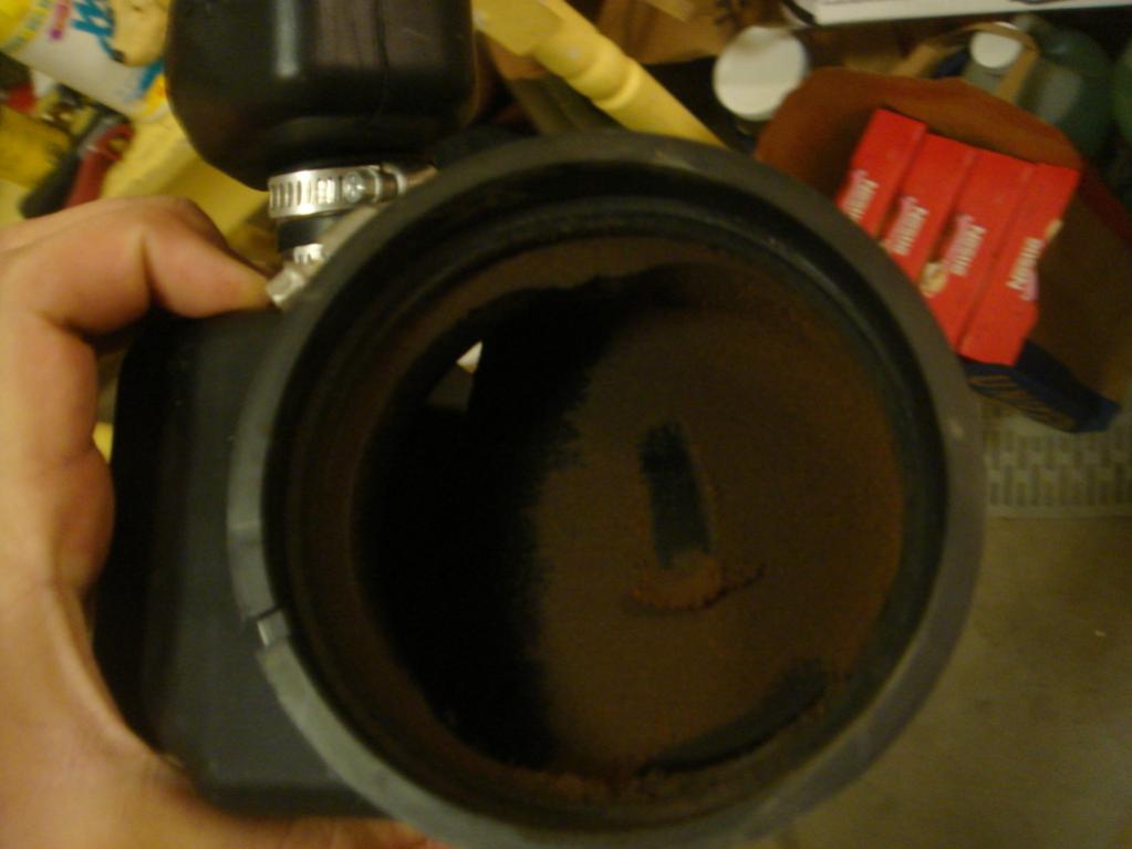

Originally Posted by Dirtjunkie85
Thanks for all the info guys I am currently running a Lexx slip on exhaust and a Lexx Fuel controller I just have not done the intake yet and was curious how much more it would give me on top of what I have? I would say the exhaust and fuel controller added about 5 horse so hopefully I can get another 3-5 out of a intake.
Yes, you can get that much more out of an intake if you go with one that actually replaces the intake tube... The problem is the part of the stock tube that is plastic and molds around the rear shock.
Here is a picture looking inside of the section of the intake tube I found on the internet.
