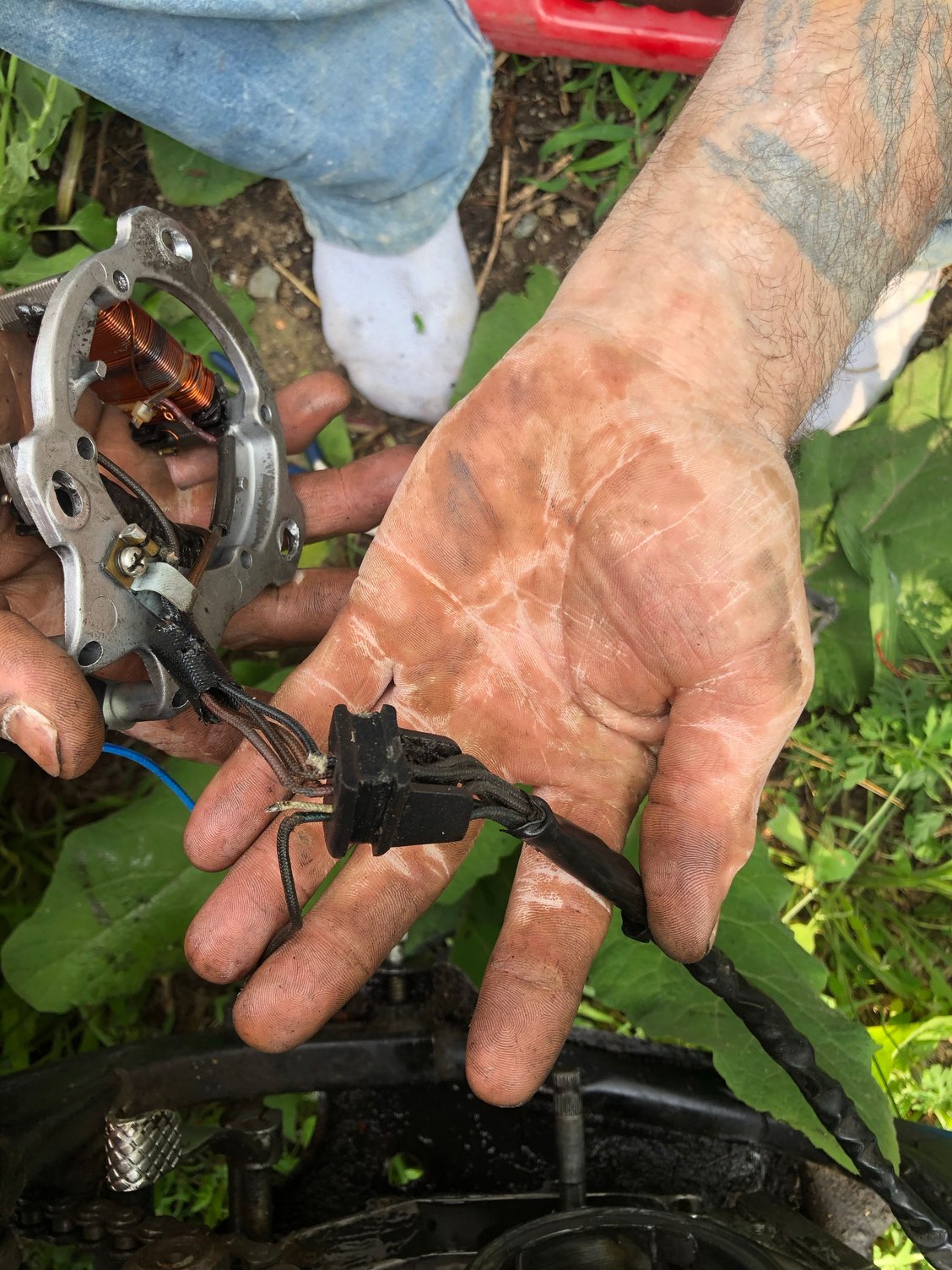

Hey everyone, I recently purchased a 1986 Suzuki LT230s. Everything looked great, but there was no spark. Replaced the spark plug.
We were certain it was the CDI box, but after a new replacment; that was not it.
I took off the crank case and found that wires going from a cable into the magneto, on the ignition coil were broke off. Does anyone have any idea where I can find any replacements, or how to fix them, possibly?
Any answers or recommendations would be great, I appreciate your time!
