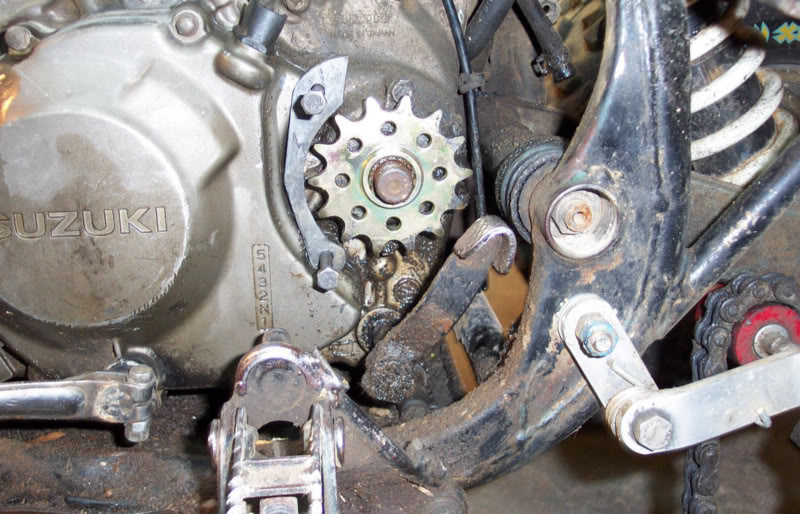

My 14 tooth:
That's just a hunk of flat steel I made to look like a case saver. It held pretty good the last time I rode with the chain popping off every 2 min.
I tried pretty hard a while back to find a 38 or 37. I guess I could have one custom made, but the prices shoot up exponentially.

I had the 14 tooth on the last time I was riding when I was bitching that my chain was flying off every 2 min. It was really no big deal though. I just had to find neutral and put the chain back on the back sprocket and roll the quad backwards. Then I was good for another 2 min when it popped off again. The key is to have a case saver the fits really tight against the sprocket so it doesn't suck the chain around it. I couldn't use a 12T with the same case saver as the 14T. If the chain ever popped off it would be a wadded up mess.
The 14 would be ok if I had a little more torque, but its just too tall of a gear,, even with a 41 on the back and 20 inch tires. In OH it might be good with all the flat ground up there. In the mountains here, 13/39 is too low and 14/41 is too high. 4th gear is the main problem. Too big of a gap between 3rd n 4th.
The 400 shocks sound ok to me, if you can get them on there and get the geometry right. That's the biggest problem I had,,, the geometry. Once you change the a-arms, things don't work the way they used to. The shocks are either too stiff or too soft. That's why I have 4 or 5 bolts holes in the top mount and a couple holes in the bottom mount.... trying to figure out the geometry.
