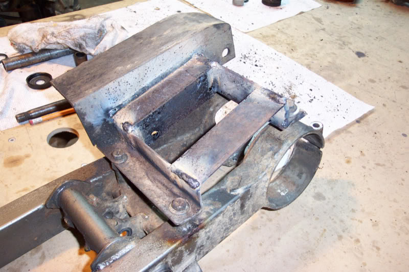

This is what I rigged up. Where the bolts are is where I was having a lot of problems. The perches under the bolt heads were trying to come thru the steel. They had stretched the hole and almost came thru after only one ride. So, I doubled up the steel. At the time, I didn't have back brakes is why there is no rotor guard here.
