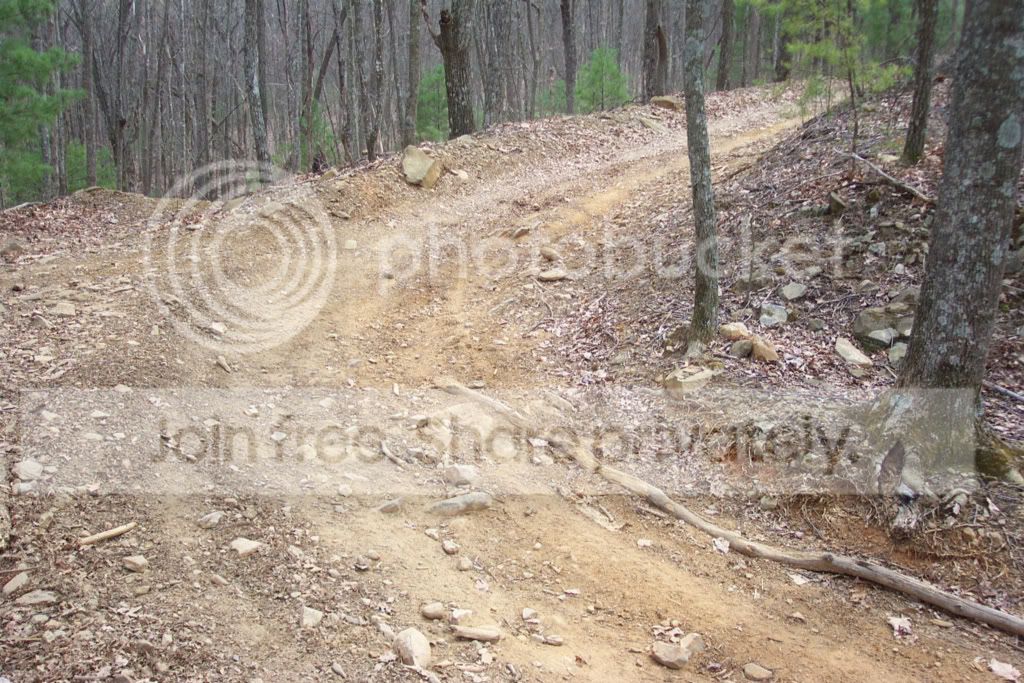

http://www.georgiaoffroad.com/map.php I've been to most of those in the Chattanooga area.
They're all mostly trails that look like this:
Just miles n miles of trails. They maintain the trails with bulldozers and the dozers make a LOT of "jumps" in the trail. It gets to be a pain in the *** after a while. Literally. I was talking to a guy that suggested the "jumps" are probably erosion barriers to slow the water down the hill. Makes sense. I figured they were for jumping!
Anyway, my point was (unless I'm site-seeing) the utes get kinda boring or scary. Nothing really inbetween. That's the way I see it anyway. Most people ride utes up there though. So, it has to be fun in a way. Maybe I'm too high-strung? [img]i/expressions/face-icon-small-confused.gif[/img] [img]i/expressions/face-icon-small-happy.gif[/img]
My friend with the 250S says he likes to go up there and just "cruise". I think its just that he's slow! [img]i/expressions/face-icon-small-tongue.gif[/img]

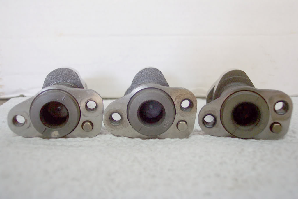

Left cam is the 250 cam. Middle is 230. Right is LT4WD.
Look how loopy the 250 cam is! The 4wd cam has a sharp dropoff at the right of the lobe.
They're labeled G, E, D respectively. (not on purpose, lol).

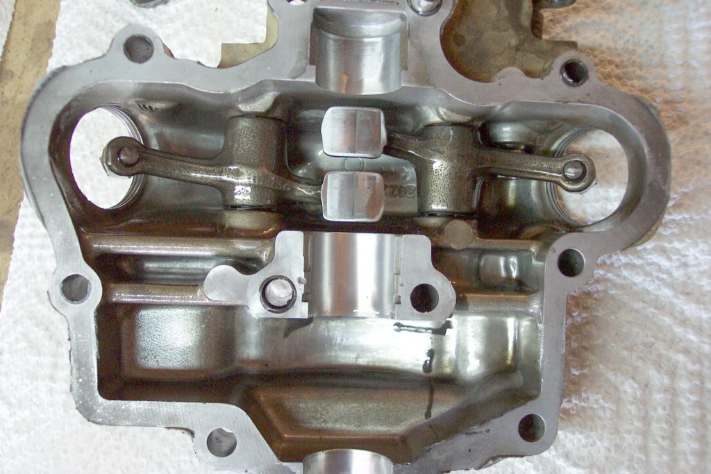

If you guys ever have the valve cover off, pay particular attention when applying rtv to the area shown in the top of this pic:
You do NOT want the rtv to squeeze onto the cam bearing that is all too close! So, each time I "pop the top" I pratice just how LITTLE rtv I can put on. And definitely around that bearing area! Just wanted to give a heads-up on this one.
This cover is uncleaned! I just took it off. (The black globs at the bottom is some kind of paint or something from the factory... Not rtv). Pretty clean for a "goop-jpb".
There are also 2 long bolts that have washers and maybe some rubber or silicon under the heads. Make sure you clean and use new rtv on the 2 bolts/washers or it WILL leak oil.

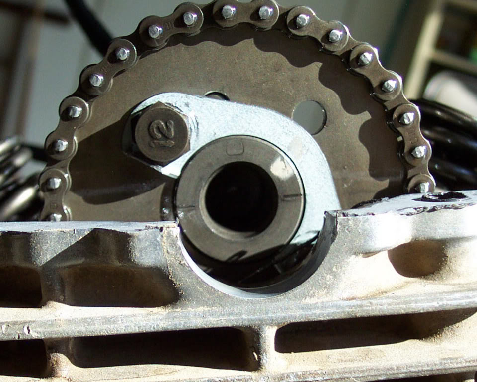

This pic I snapped just because so many people want to know how to set the valves or wonder if they have the timing 180 out:
The cam should be positioned as shown and then used the feelers to set the lash. It cannot be 180 out of time because the sparkplug fires everytime the piston is at TDC (+ whatever advance the cdi uses).
