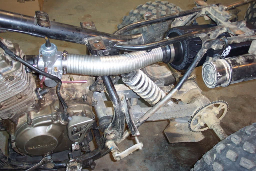

thank you for your input! does anyone know about the intake? can i just put a tube coming off of the carb and put and air filter on it?
You mean without an airbox? If so, you'll have a lot of carb tuning problems. It can be done, I did it, but I had to drill out monster jets. And I have a dial-a-jet.
Old May 14, 2009 | 04:20 PM
  #7068
Spencer2829's Avatar
Joined: May 2009
Posts: 27
thats the thing though... the tube between the airbox and carb are gone so its just an open carb when i got it and it runs fine
You better get some kind of filter on there or you'll have a worn out intake valve.
Hard to believe it runs fine, but if you say so, ok. The guy that sold it to you might have been good with carbs, but if he is, why did he not put a filter on it? Surely he'd known the intake valve wouldn't last long.
Anyway, I see 2 choices. 1) put it back to stock with parts from ebay. 2) Do what you're thinking, but be prepared for a lot of jetting problems.
Here's what I did:
Getting mud on it is a problem too.... In addition to the jetting puzzle.
