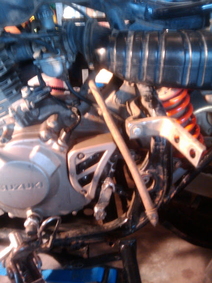

I honestly don't know haha! Maybe I'm missing something that is supposed to bolt on there so I have extra length left over or something, I really don't know. When I got my nerfs I simply didn't like the fact that it was cheap allthread with a nut tack welded on the top to act as a head. So I said "Eh what the heck, I'll try my oem bolt" and it fit perfectly.
Otherwise, the only "mod" I really remember doing to make the nerfs fit was I had to grind down a little tab of some sort on the right side footpeg. Did you have to do the same?
