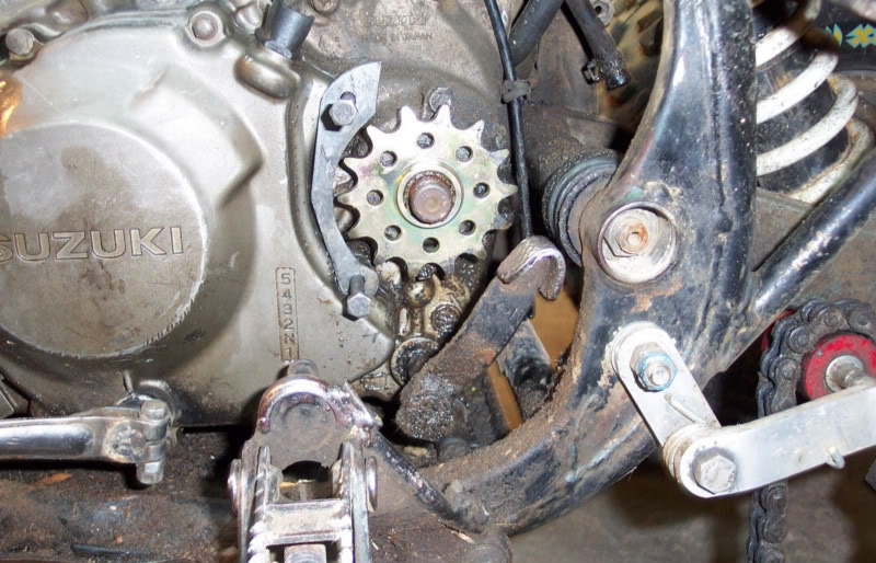

so that bolts right on to the foot peg and everythings good?
Old Apr 15, 2008 | 09:20 PM
JustRandy's Avatar
Joined: Mar 2007
Posts: 5,227
Default lt230 lose chain
No, you have to drill a new hole. I have a pic somewhere.... hang on.
Old Apr 15, 2008 | 09:22 PM
JustRandy's Avatar
Joined: Mar 2007
Posts: 5,227
