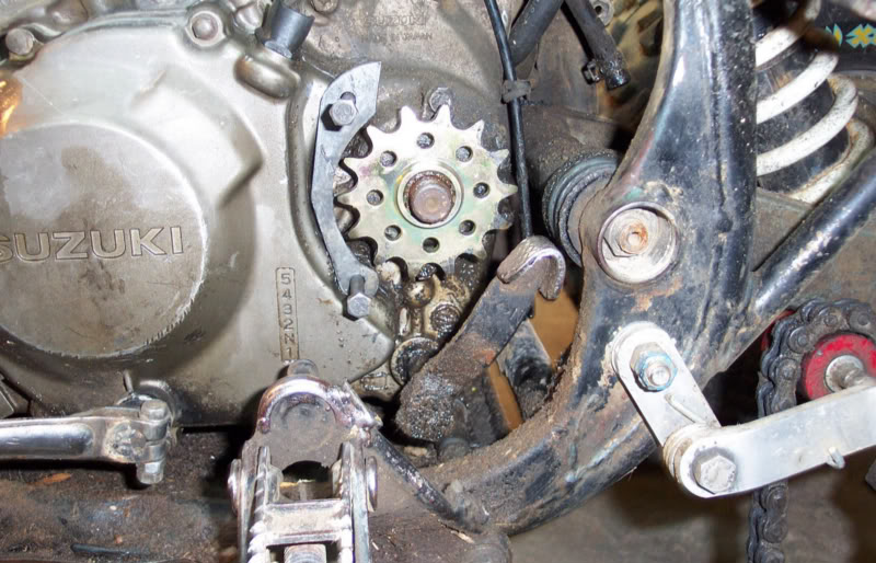

There should be a chain guard for the case. I made something like this. It should sit VERY close to the chain around the sprocket.

just randy is thier anything between the sproket and the case or is it just that pice i can see

Just that piece of metal.
