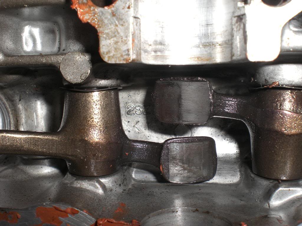

So I took the cover off and this is what I found. Was the timing chain too lose and did some damage? Also, can you tell from the picture of the rockers if they are still good? How do I know if my cam is shot?

judging by what i see. whoever sealed the valve cover use way too much RTV. you need too seriously clean that head. remove the cam and really clean it. i dont really see too much damage, rockers look worn but ok to use, cam i really cant tell because i can only see1 side of it but it looks like it needs cleaned. and sand the valve cover where it looks like the timing chain hit. just knock down the high points and you shaould be fine.
And it is important to remember when you go to reassemble, you only need to rough up the sealing surface with sandpaper and only use an 1/8th to 3/16 inch wide bead of RED RTV silicone around the outside perimeter and dont use too much.
i think you may have silicone in the engine block itself. A little silicone in there will definately fry your oil pump. i recommend a complete tear down and engine flush. pull the jug off without separating the head and split the engine cases. make sure there is no RTV in there. If you dont and there is RTV in there, it will cost a ton of money to fix your engine.
you may try drianing your oil and check to see if there is chunks in it if you dont want to split the case, or you could take your mag cover off and use a bright flashlight and check through the oil passage holes also.
go to this link to see what kind of damage will occur if the valve cover is sealed wrong.How-Not-To Seal Your Head - Suzuki LT230S Vault
