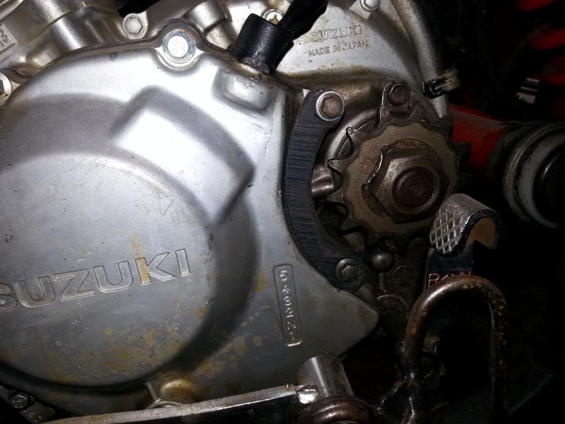

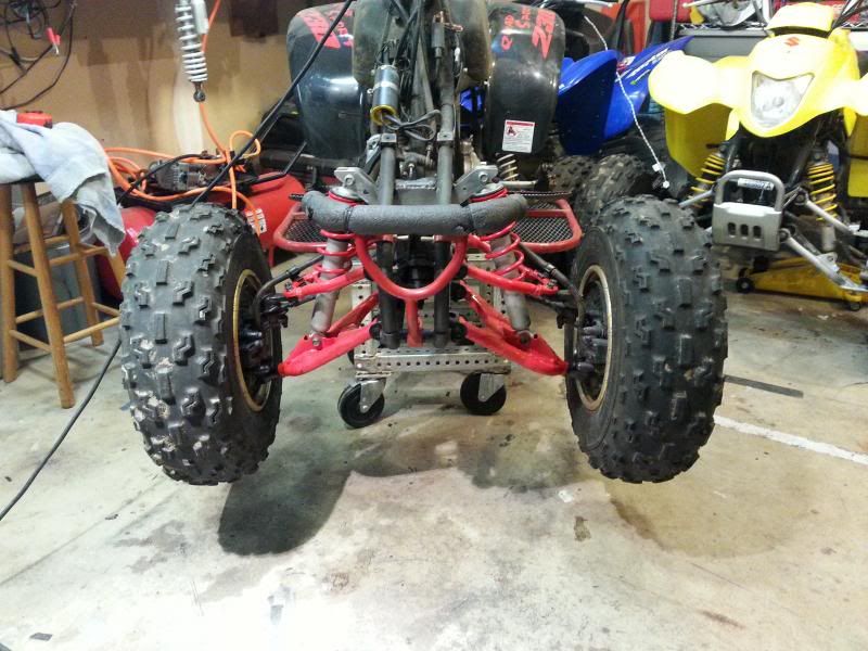

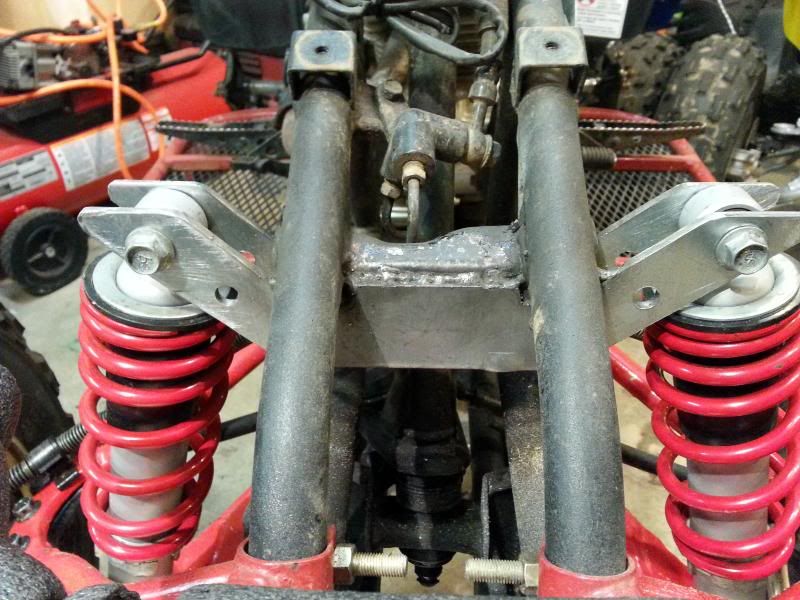

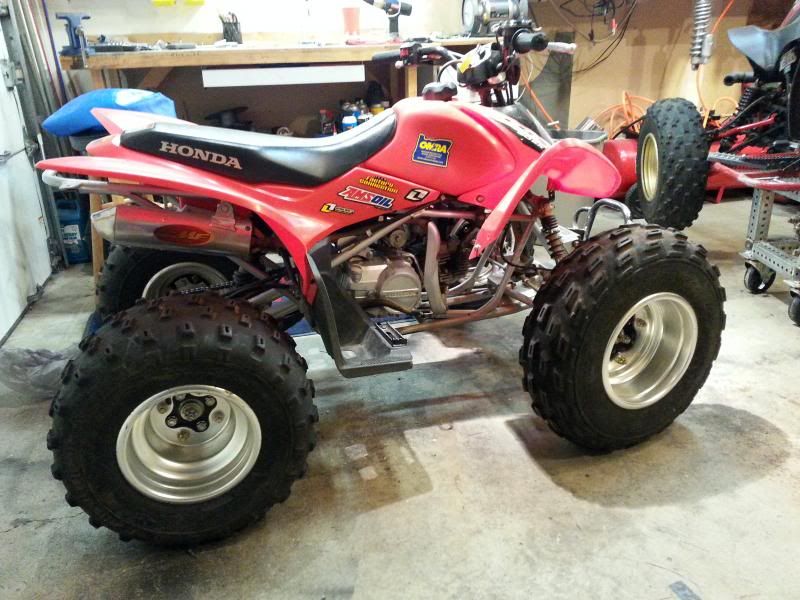

So I have some up dates to the old girl. I made a case saver & Shocks brackets So I can run any LT250, 250ex, 300ex, raptor 250 and lt230s front
http://i638.photobucket.com/albums/u...107_183922.jpg
http://i638.photobucket.com/albums/u...107_183824.jpg

That's similar to what I did with mine. Except, I cut off the old bracket and just welded a new one above the frame.
Is that a z250 in the background? If so, your front 230 shocks will fit on it and lower it about an inch. In the rear, you can take the 230 spring and put it on the 250 shock.

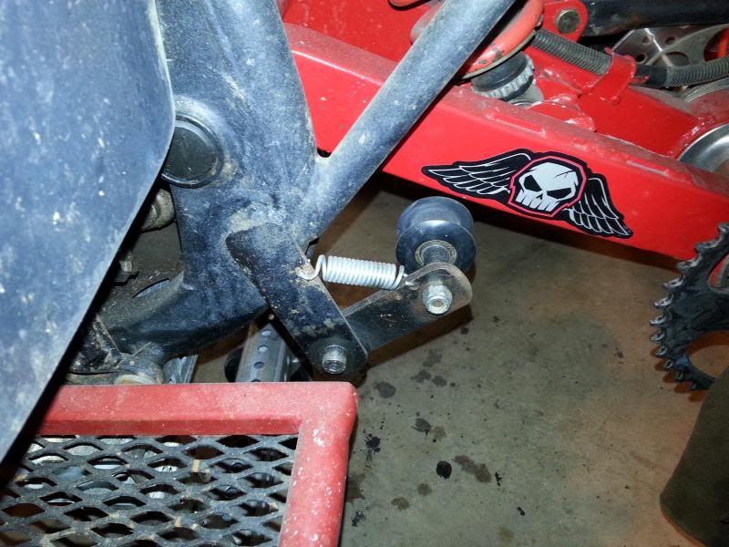

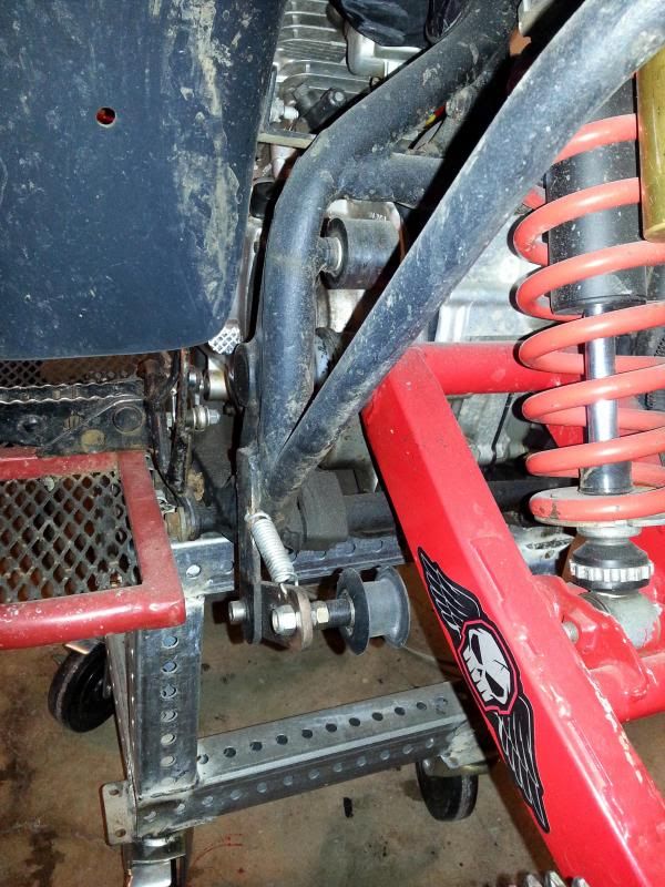

Nice looking LT230. Do you have any closer pics of that chain tensioner setup?

Chain tensioner :
On the chain tensioner I made some steel brackets and a skateboard wheel. I took my bench grinder and used the width of the grind wheel because its the same size as a 520 chain and cut down the middle even.
http://i638.photobucket.com/albums/u...intension1.jpg
http://i638.photobucket.com/albums/u...aintension.jpg
Case saver:
http://i638.photobucket.com/albums/u...scasesaver.jpg
Air filter:
On the air filter I just ordered a 2 stage filter on Ebay that would fit the the carb and picked up an outerwear to go over it when I take her to the dunes. I haven't had one problem with it. Been running like that since I got it.
Yes I own a 07' LT250 and a 07' 350 raptor and a modded 08' TRX90.
http://i638.photobucket.com/albums/u...231_162141.jpg

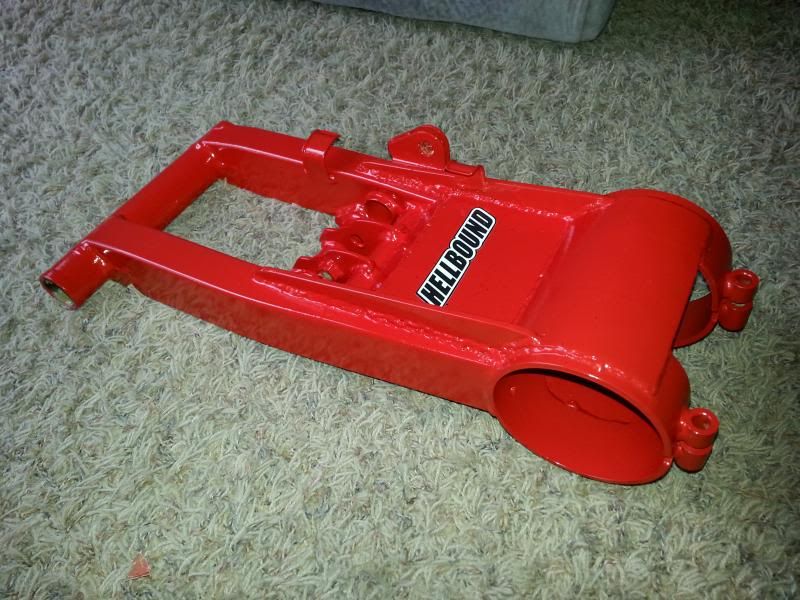

Default Swing Arm Update.
Modded Swing arm and Harbor Freight at home power coat system.
Step #1
Step #2
Step #3
