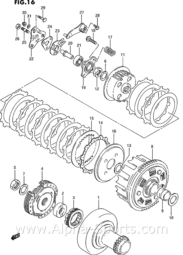

so if im reading this right turning adjuster in = less clutch? This is a automatic clutch so no pedal to have play
Old Apr 23, 2014 | 11:51 AM
JustRandy's Avatar
Joined: Mar 2007
Posts: 5,227
I forgot whether turning it in or out means less clutch. You have 3 clutches and one isn't automatic. There is a centrifugal clutch (#4 in pic) like on a go-kart that allows you to get moving from a stop. There is a one-way clutch (#3) which lets the engine brake. Then there is the gear shifting clutch (#14,15,16) which is what we've been talking about.
