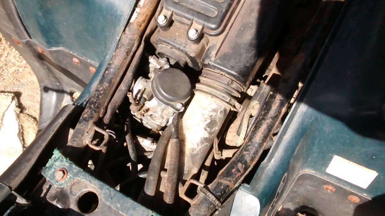

carb isn't mounted, sorta messy under there:

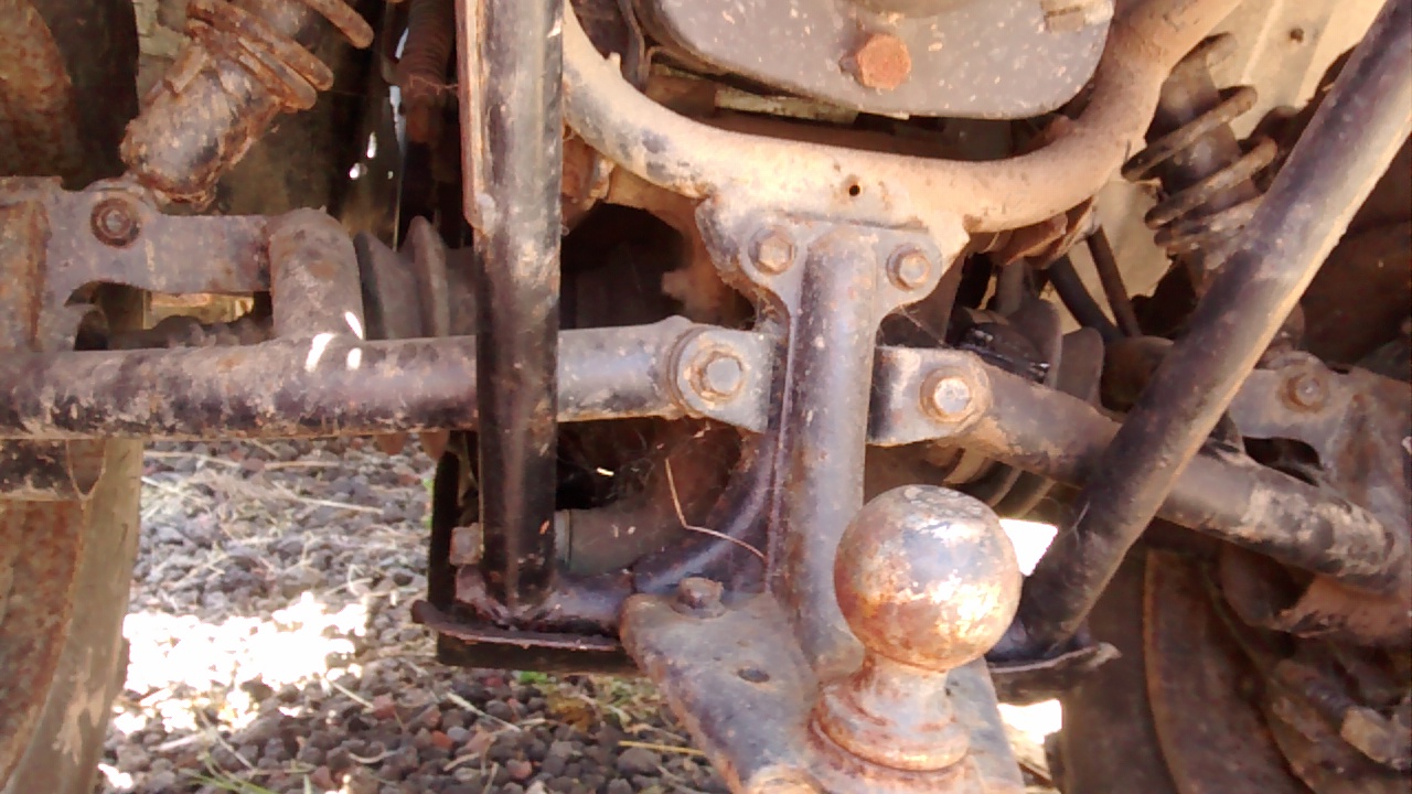

rearend didn't look terrible:

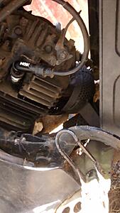

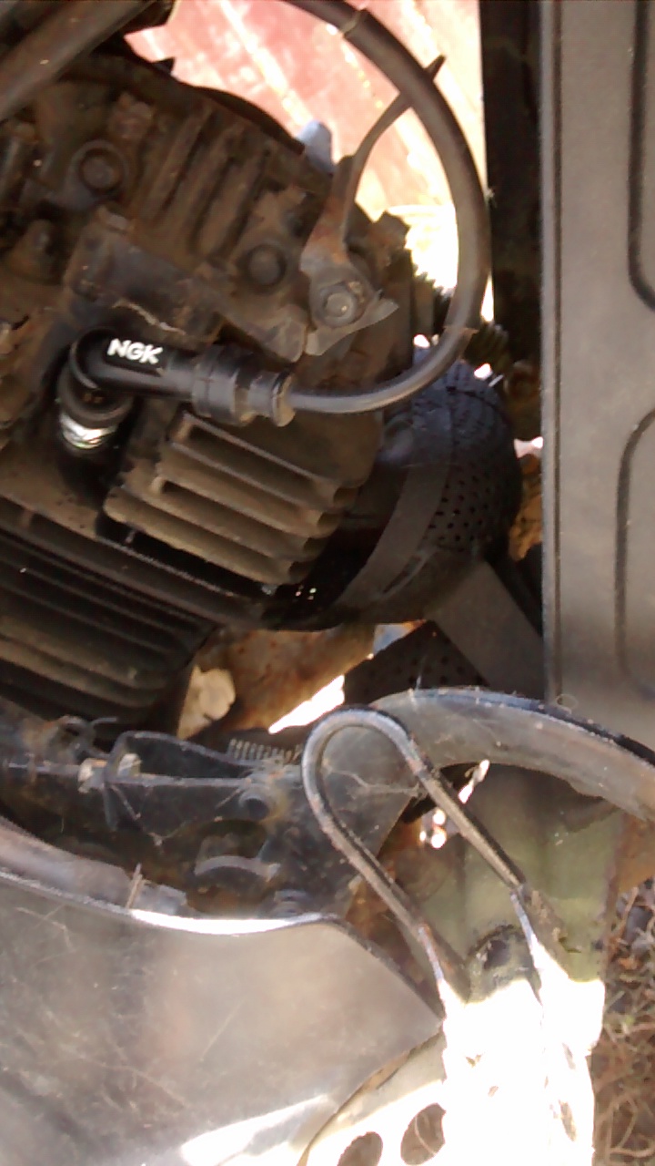

new wire and plug, useless right now though:

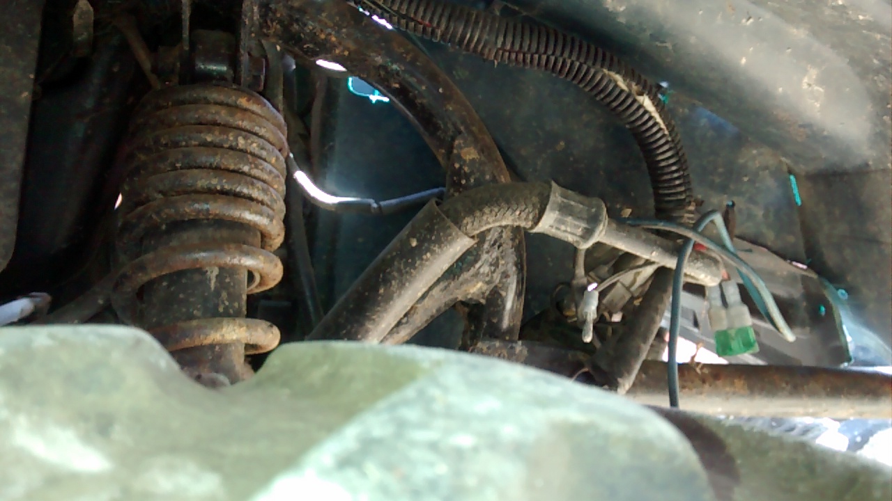

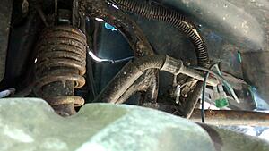

wire harness under left front fender, one fuse visible, the dual fuse holder with two blue fuses out of shot (oops):

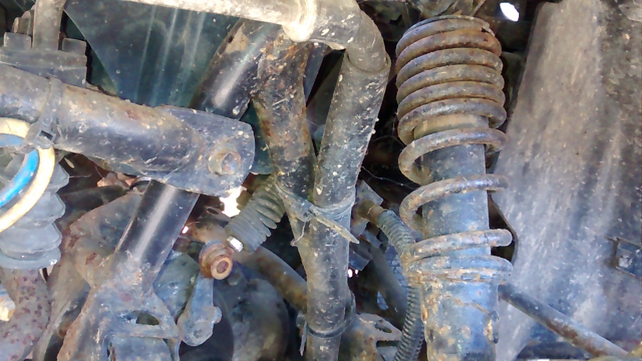

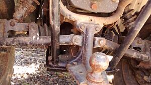

Front suspension area, boot/arm/shock...bumper on left:

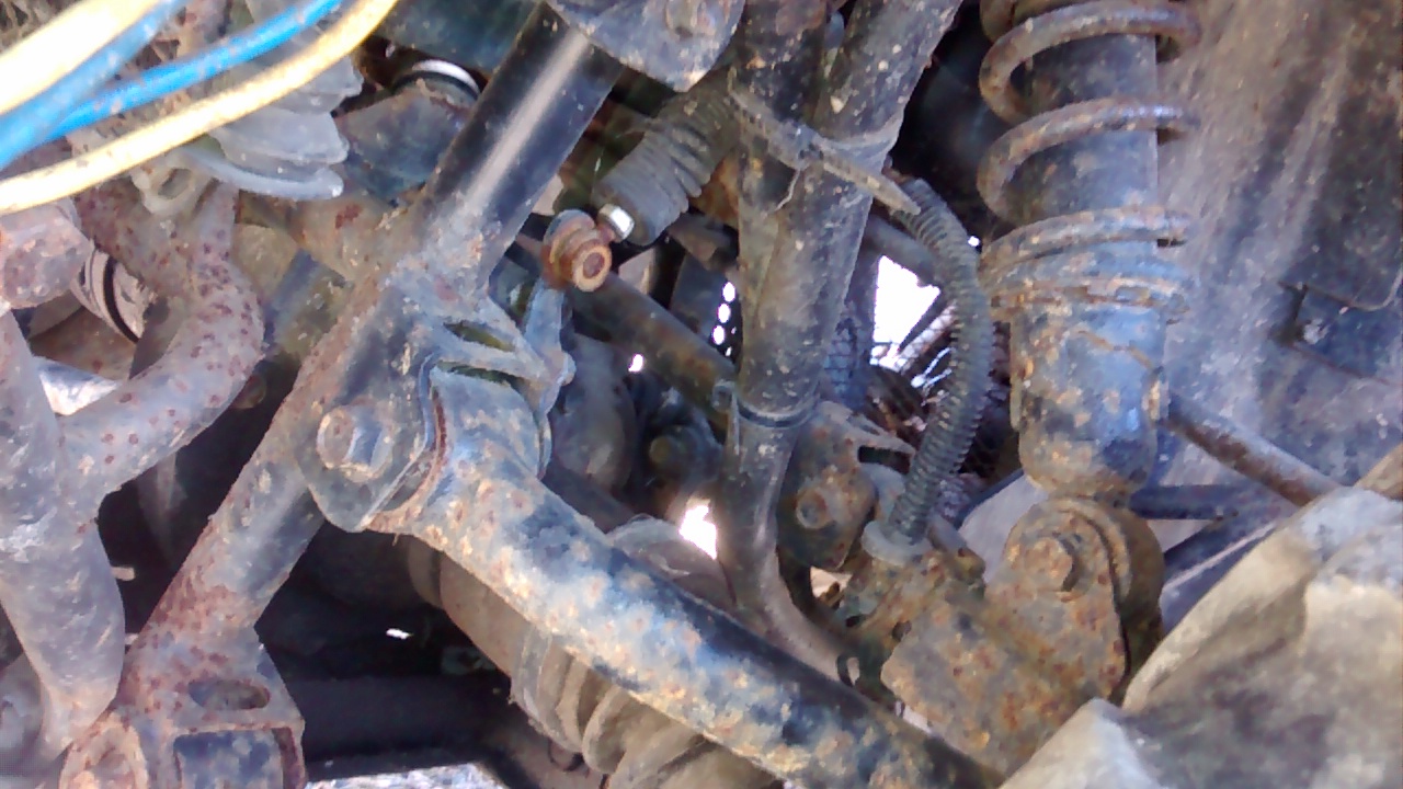

little higher up:
little higher up:
