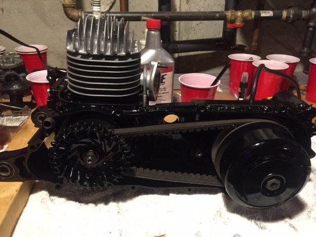

Can't tell from the vid, but were those head/cylinder fins ever coated (like powder coat)? While PC will make it look much better, it's a thick coating that will trap heat...just a thought...

yes 3 coats of bbq paint. hmm, that is food for thought- I have a feeling they bored it with to little piston to cylinder clearance- ran it today with temps well below freezing, no noises so I did a longer spin around the driveway (like only 1000 more feet) and it started making that noise about 50 feet away from the house, it locked up as soon as I let off the throttle.

I PC'd my motor but left the cylinder alone...air cooled machines rely on that heat transfer...I'd strip the paint if I were you...

yup, noise started and I thought oh what the F and tried to make it another 50 feet, let off the throttle and it instantly died- was able to pull it threw immediately after though, I'm positive its grabbing the skirts- I will pull it apart and post videos. Maybe the previous owner played with the timing? THe factory paint was burnt off the cylinder as it ran hot even before I rebuilt it.

There is no paint on a factory cylinder/head.
Like I said, pull the head and see what the piston/cyl looks like now. Sounds like it's sticking.
