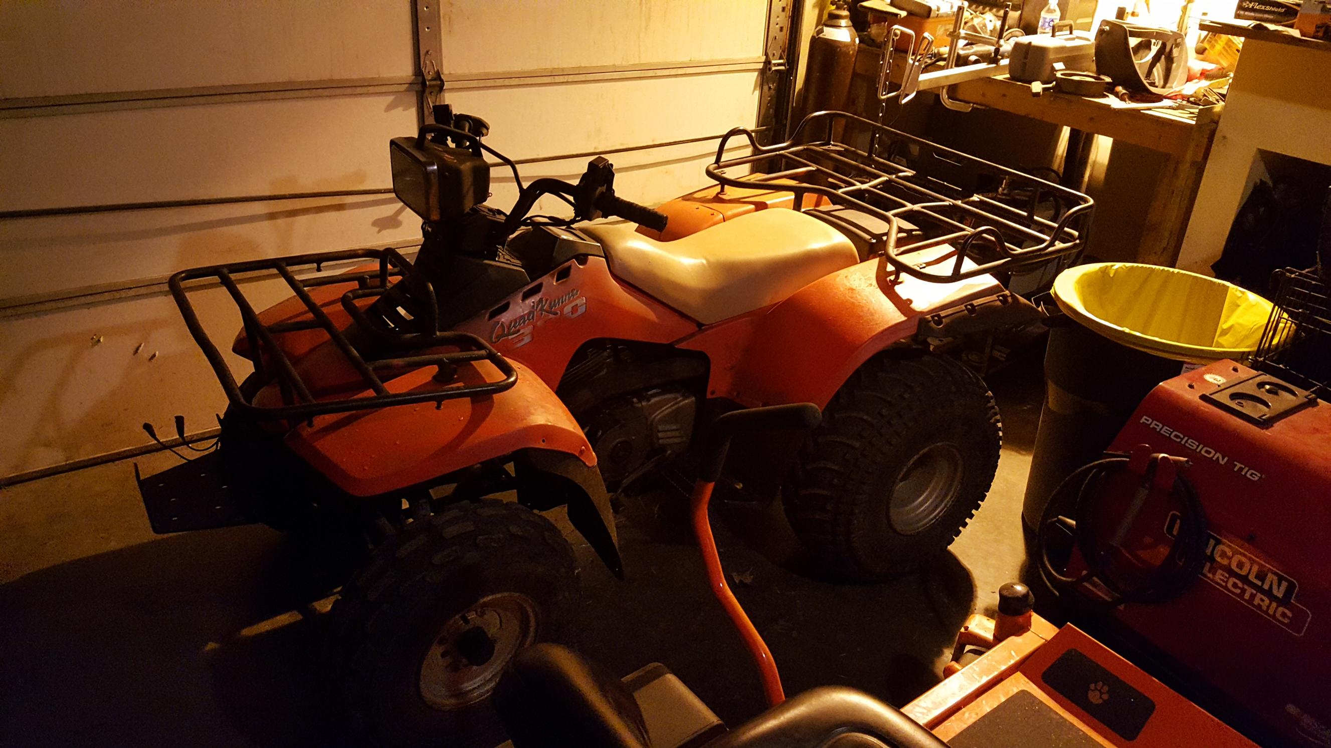

Hey guys. I just picked up a 1987 Suzuki LT300E for $200 bucks. Seems to be in good shape but is not running at the moment. Looking for some insight on where to start from here.
The problem is(I think), something internally is broke, causing the motor from turning over. Using the pull start, I can get the motor to make one or two rotations then it locks up. The quad will roll as far as you want to push it while in neutral, so I hope nothing is broke off in the transmission. The guy I bought it from said he bore scoped the top end through the spark plug but did not see any problems.
You guys have any insights? Plan is too pull the electric starter tomorrow and see what it looks like.

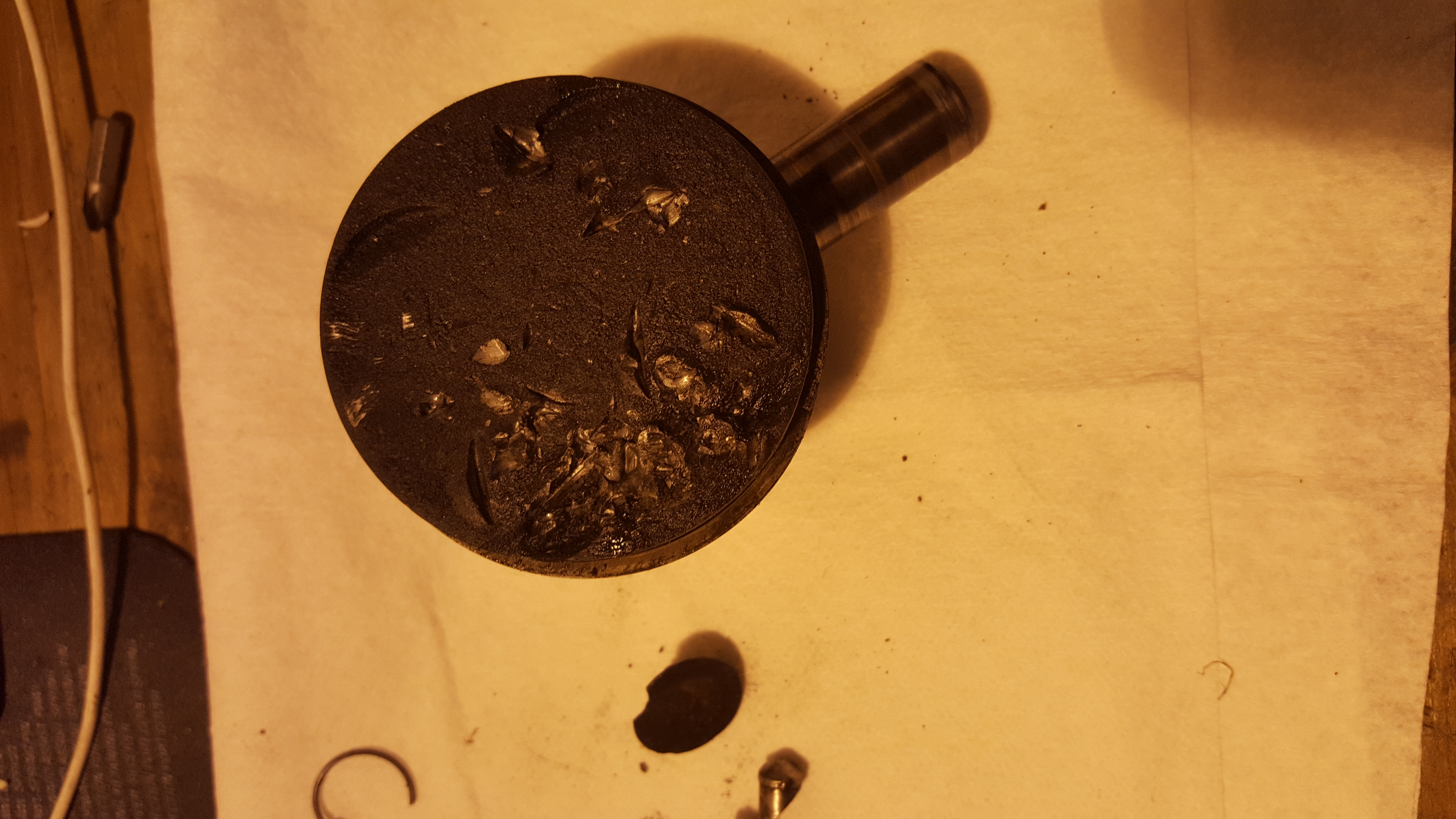

Well got the case off. Also took the head and cylinder off. Found the problem. Both exhaust valves were broke off.
Guess I'm looking at a head job and new piston. It this thing worth it? Should I look for some used stuff on ebay? Do you guys know what year is compatible?

Gonna take more than just a valve job. The valve seats are destroyed along with part of the head itself. If the rod is ok,no damage to it and the cylinder is still decent,a cylinder bore,piston and used head that you could rebuild. Just depends on how far you want to go and how much you want to spend on a 30 year old machine.87 LT300 head | eBay
