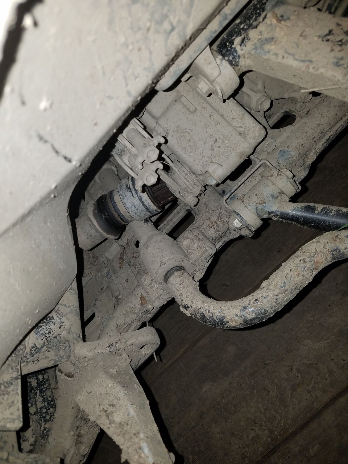

Default Here's what I found
Here's what I found. The shaft is either broke or popped out of the rear end. I didn't try to run it to see if the shaft turns yet but I am guessing it doesn't. I didnt hear any clunking when I drove it home in front wheel drive. The shaft wont pull out so I am guessing something inside the case is broke?

Default This is whats wrong
This is what is wrong.
