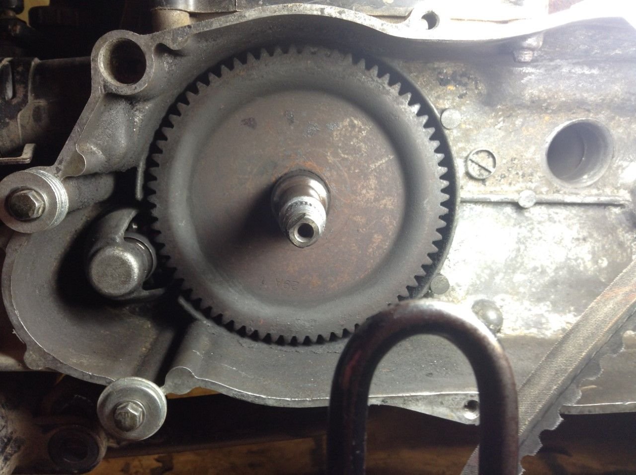

Finally got a few minutes to look into this issue again. I took a few picks and I don't see a key or an empty keyway in the starter gear or crankshaft. Also the new movable drive plate is restricted by the flared section of the crankshaft abut 1" from the starter gear. Any thoughts?
No key or keyway
plate stopped by flared crankshaft

Pull the starter gear. You have to see it.
Flared? We'll see. It's hardened so it is doubtful but not impossible I recon.
