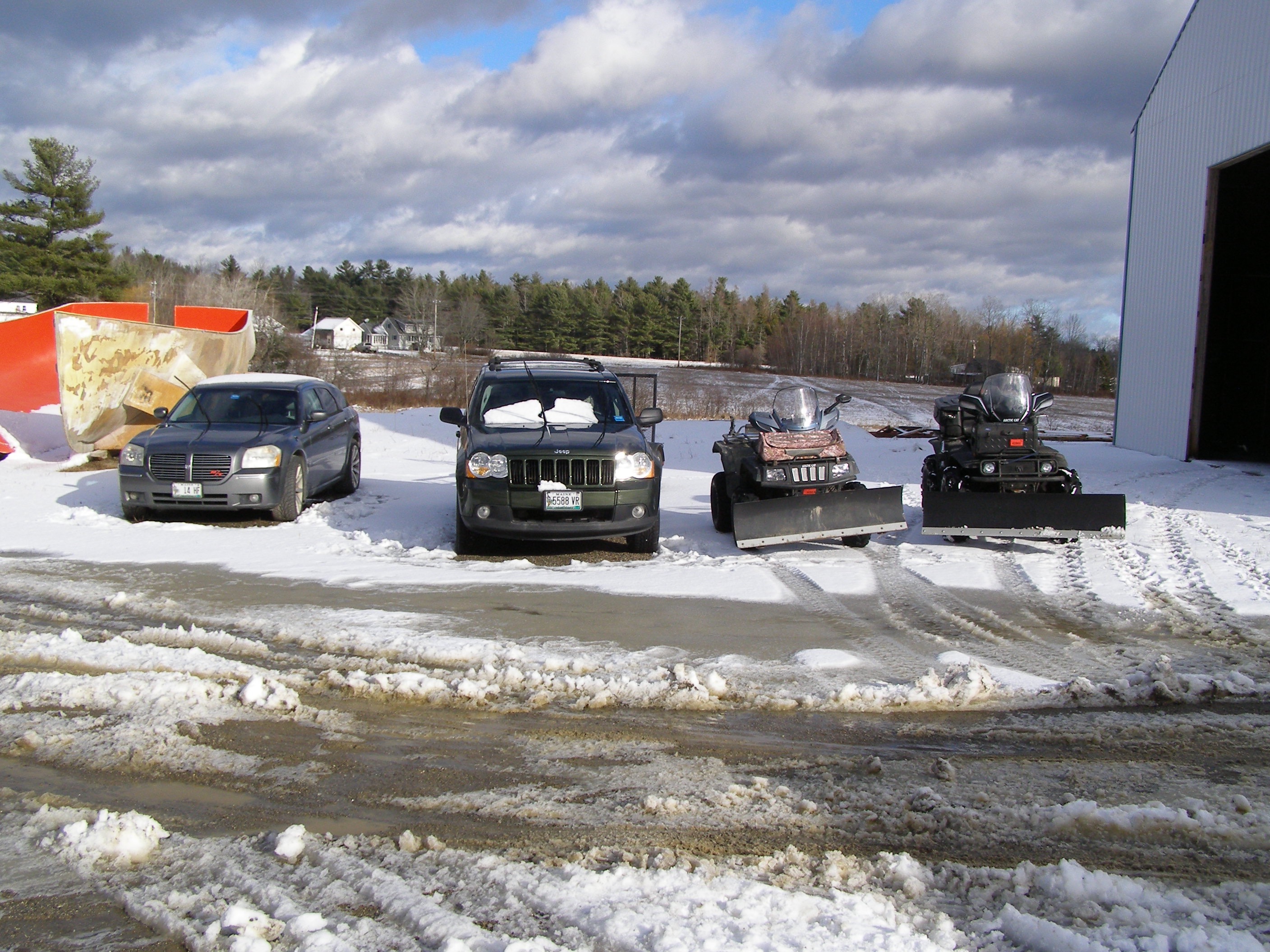

Of course it can be done, but there are many reasons why it shouldn't be done. It would have to be a custom made mount (expensive. The bike only weighs 300 lbs,) about half or less of a typical 400 cc machine. It has no low gear per say, so probably will burn up drive belt. It would have to be a manual mount that you raise and lower by hand vs winch. (charging system too small to support a winch). For about the same money, you could buy a 300cc or preferably bigger used non Chinese bike. Here is a picture of my $1,400 2002 Arctic Cat that I bought a year ago and on the right a 2001 Arctic Cat 500 that I bought several years ago for even less. 60" plow on the 400 and 72" plow on the 500. Most of the snow melted after I finished plowing, haha. The 500 plows way better than the 400, btw.
