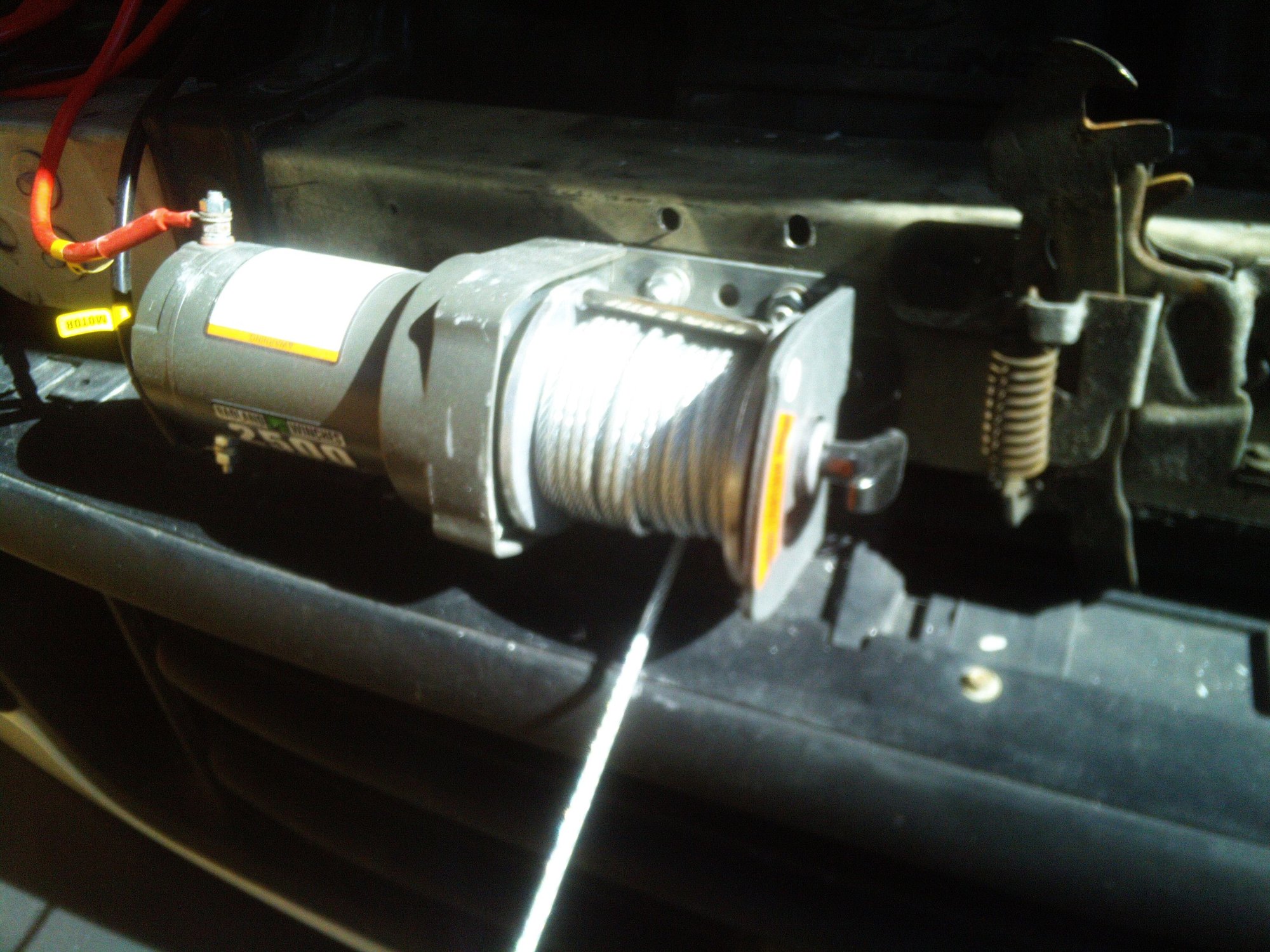

Mounted Harbor Freight 2500# winch under the hood, bolted to/against the front beam allowing full closure of hood to latch.

Visible from eyesight while plowing, with remote for winch movement up n down.
Mounted winch cable rollers onto 2x6 rested on top of bumper since all the force here is going down, then mounted on top of bumper to heavy steel plate bent in behind bumper avoiding the need to drill anymore holes thru bumper.

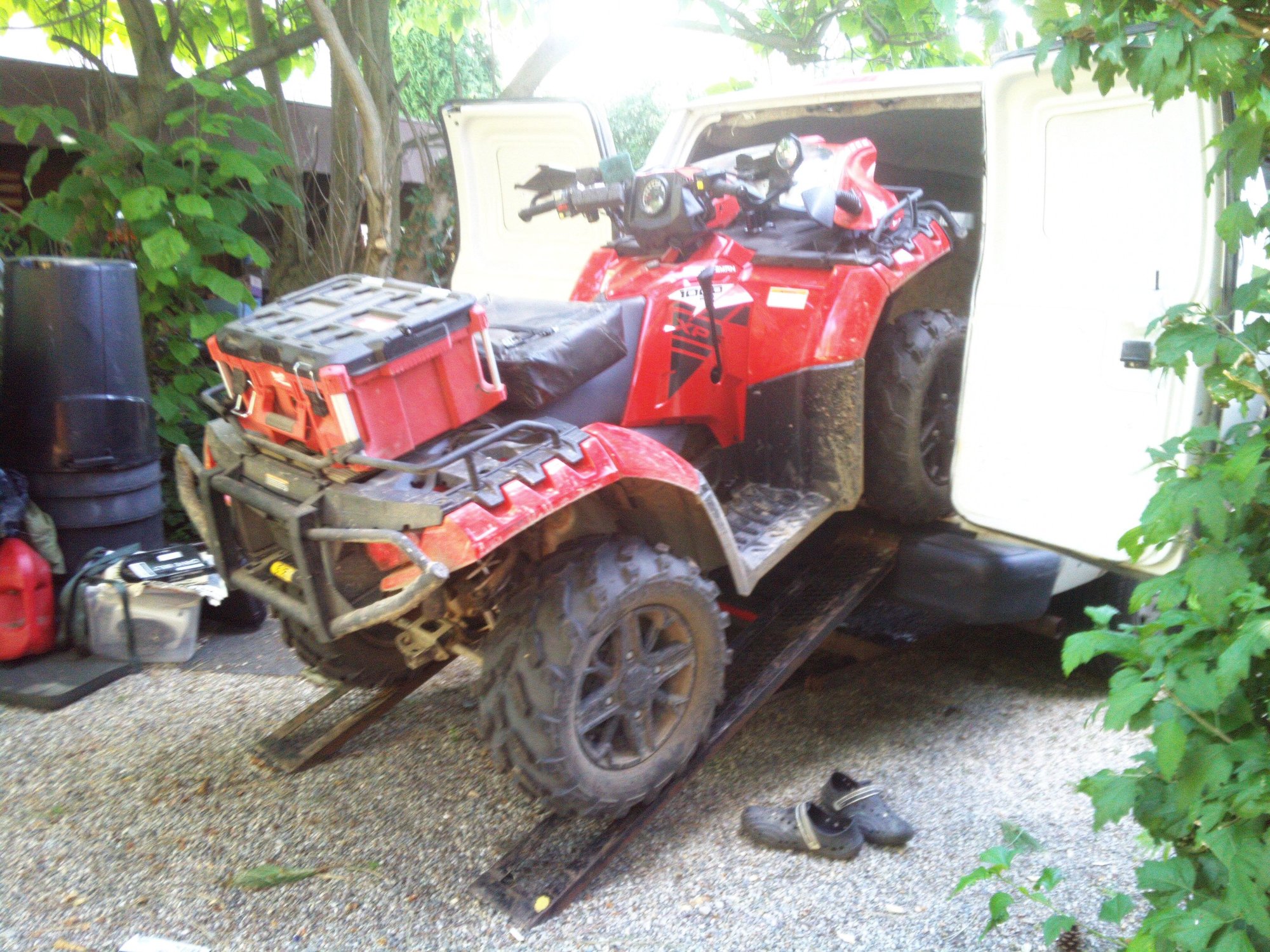

Also have a winch mounted/bolted to frame, under passenger's seat for easy remotely loading in out for cargo, tractor, utility vehicles and such.
