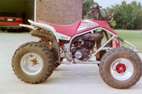

I run Klotz Techniplate Synthetic oil for injector or pre-mix. It works really well, barely smokes, even at 20:1.
I have a 98 Blaster, stock motor, with oil injection.
