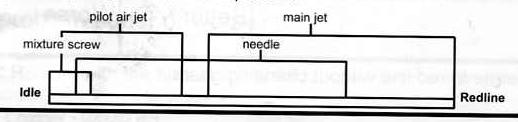

If it ran better with the choke on it's too lean. Try going up a size or two on the main jet, and bumping up the needle a little richer than it was when you started.
here's a chart that shows which circuits are active at different throttle positions.
